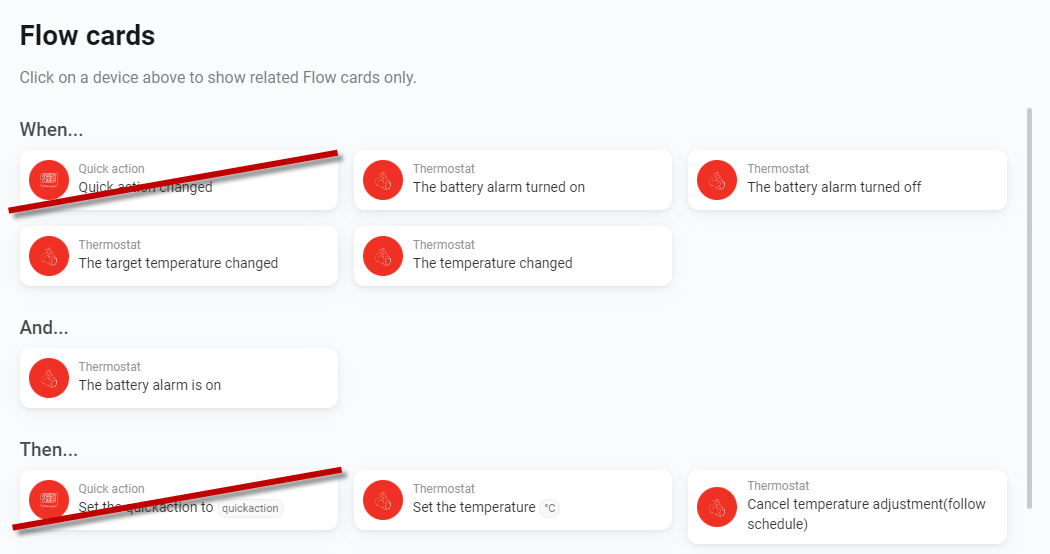

Quick action isn’t available anymore? They have disappeared from flows!? Every quick action I had configured in flows has now disappeared!
Is anyone else experiencing this?
The “Quick action”-functions are gone from the app
Read this topic 2nd entry…!!!
Add the new device card quikactions then you have a device rads with the quikaction and the flow.
Don’t forget to reconfigure your flows
