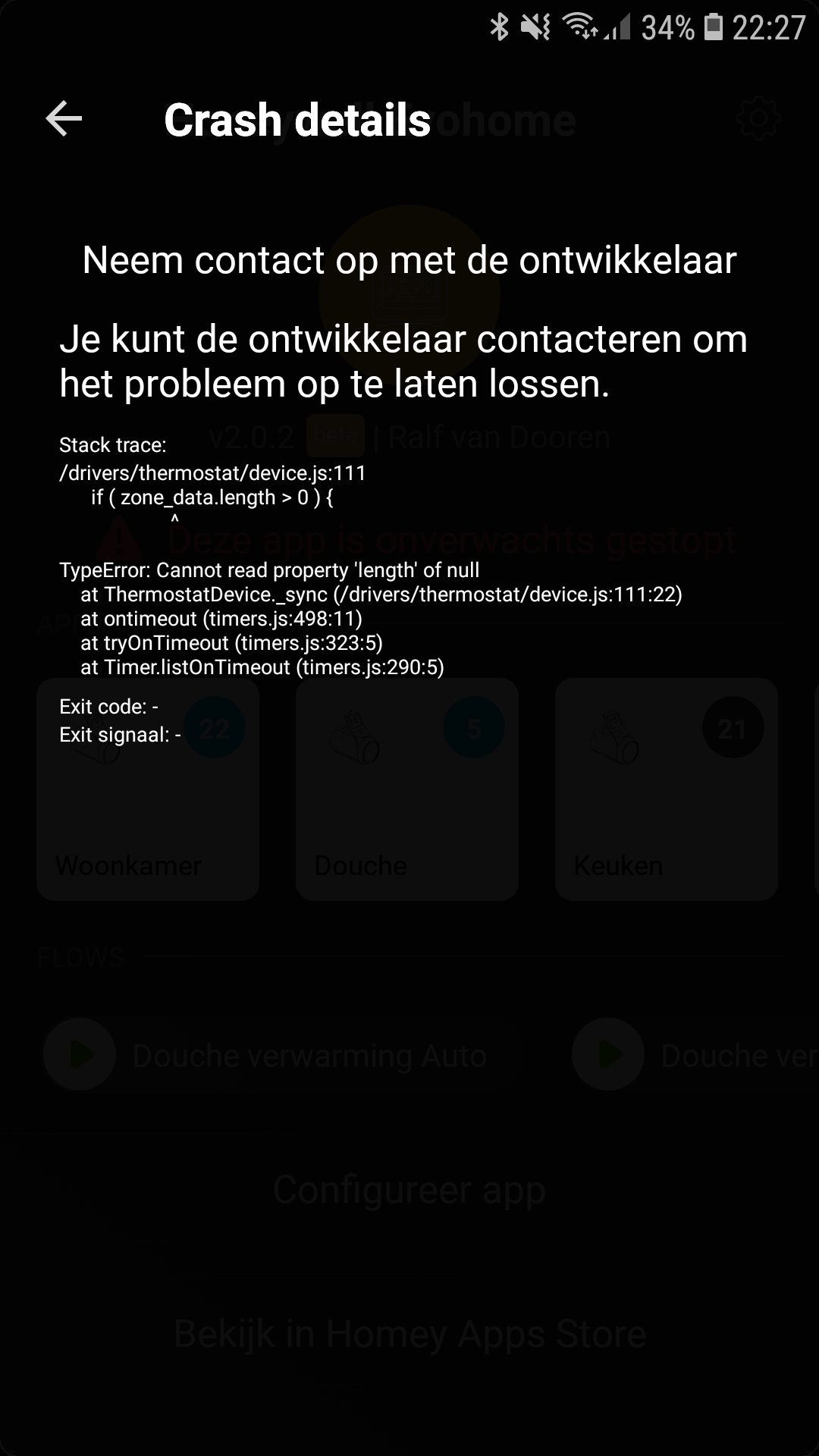

I installed the app for version 2,the beta.
The app stops working after a flow, when the window sensor is activated the temperature is set to 5 degrees, this works, but after that the app crashes most of the time.
Hi. Ik Just installed the 2.0 version of the app. When I try to add a device I get a timeout. Any Idea?
There is a new version pending approval by Athom that should solve the error crash. As for the timeout of @Remco_Ploeg : did you re-enter your username and password in the app settings? Otherwise wait for the updated beta version, that solves a lot of problems, it might also fix your time-out issue.

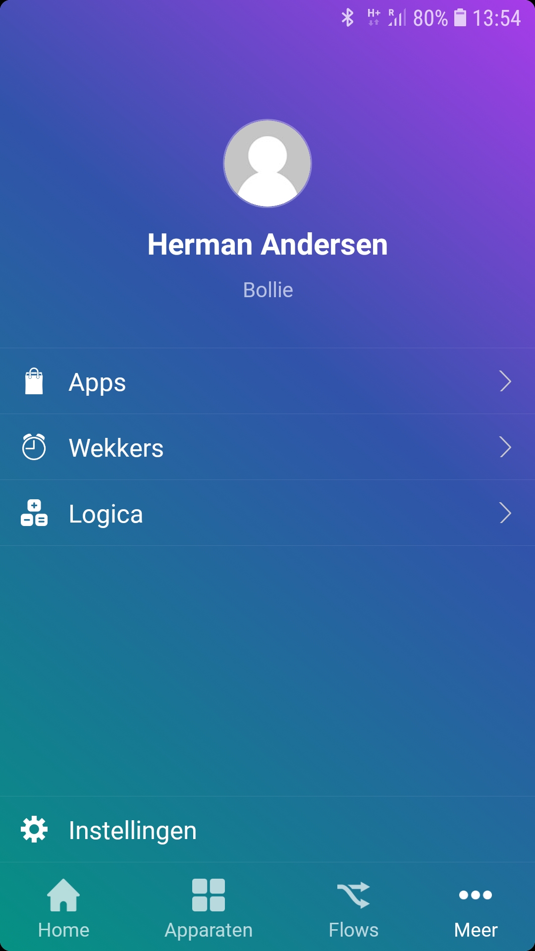

In IOS , you need to click ‘more’ (bottom right), then “apps” and then find “Honeywell Evohome”. Click that and then ‘configure app’ . Here you can fill in the username + password of your Evohome system.

It’s not in the app settings directly, see picture bottom.
Click on Apps, then select the Evohome app and then select configure.

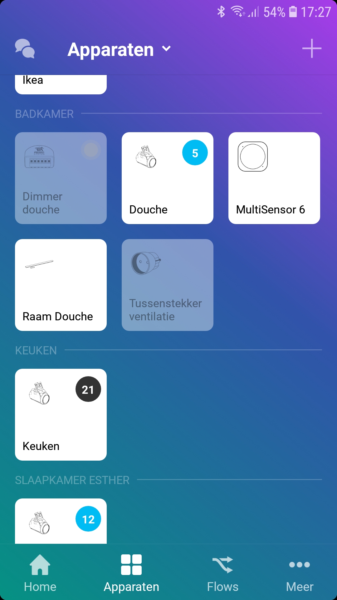

I still have problems with a flow, the app doesn’t crash but it doesn’t work right for me.
Window contact opens, then set temperature to 5 degrees after 60 sec.
What happens is that on the app temperature is set to 12, but on the evohome unit it shows 5 degrees.
For returning to normal after window closes I used cancel adjustment (annuleer aanpassing), but now the temperature on the app goes to 5 degrees also and then it stays at 5 degrees, even after 5 min.

But there’s some mix up also, the app shows 12 degrees, coming from 21, so the flow triggers something, but on the same time on the evohome panel on the wall it has the correct setting of 5 degrees.
The app goes to 5 degrees after the cancel adjustment, and it stays like that on both, panel on the wall and app, I waited a full 5 min, that’s about 2 times the update to the cloud if I’m not mistaken.
