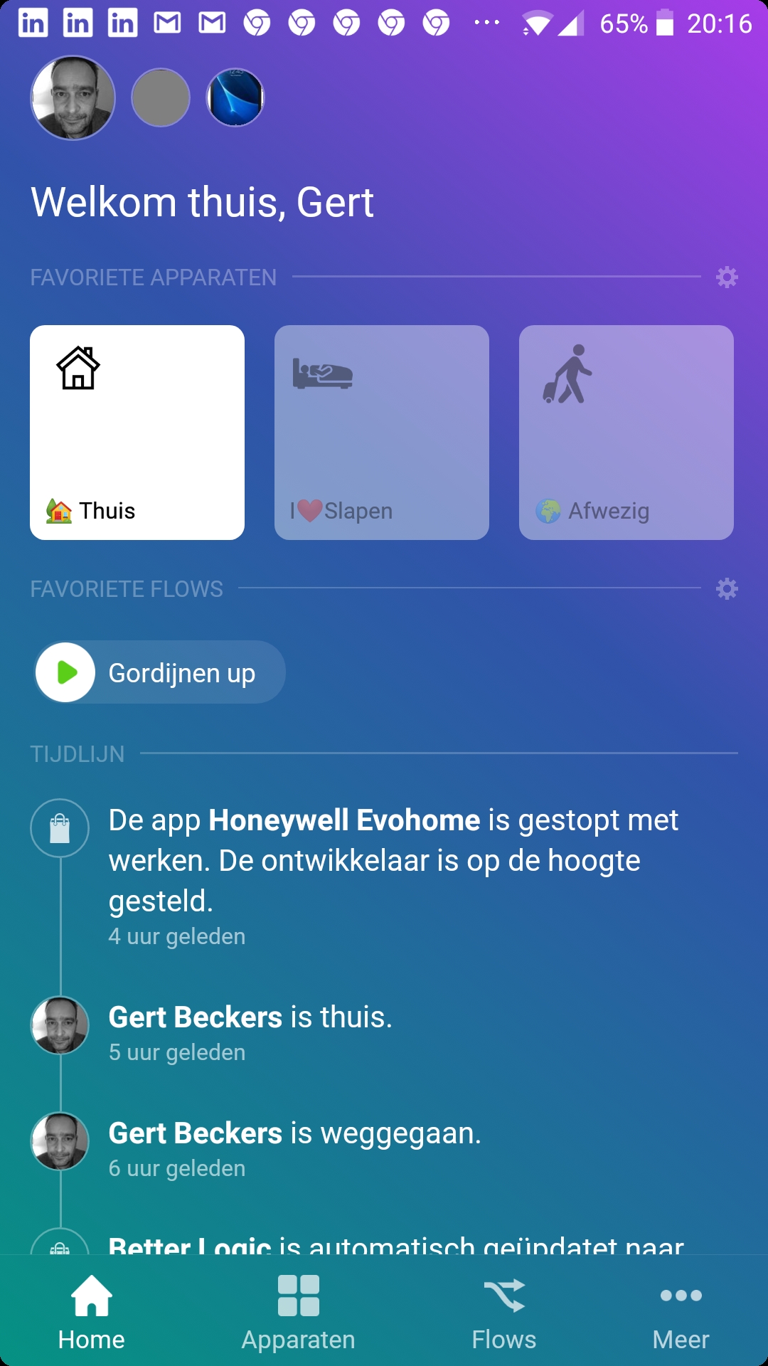

Yesterday, my 2.03 suddenly stopped working. Crashes all the time.
For now it is fixed by manually installing the 2.1.1 alpha release using CLI.

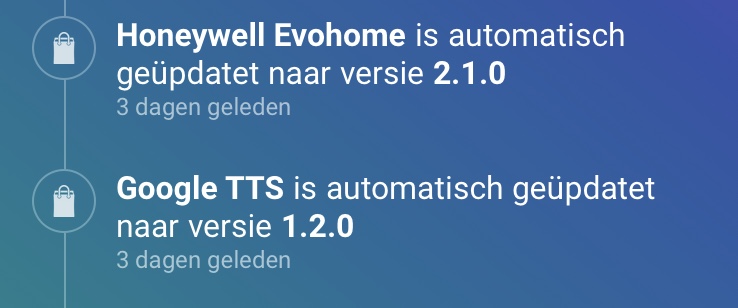

For the people who are using the Beta app : was the latest upgrade done automatically? Did you need to upgrade manually and if so, did you do this via the Homey app on your smartphone/device or did you use the apps.athom.com website ?
Reason I am asking is that in the Alpha group the automatic upgrade isn’t happening, and manual update via the app isn’t working either. Only upgrading via the website works.
Before I promote Alpha to Beta, I’d like to make sure this error isn’t caused by the app, but it is something internal to Homey.
I got automaticaly updated to 2.1.0 three days ago.
For me the same as @Moek.
I also got it automaticly in the app (2.0.6.250)
@ermep01 and @moek , thanks for the feedback . It is now reported as an possible issue to Athom. In the meanwhile, the latest release (2.1.4) is now pending approval from Athom to be released to Beta, which after that will be promoted to stable.
