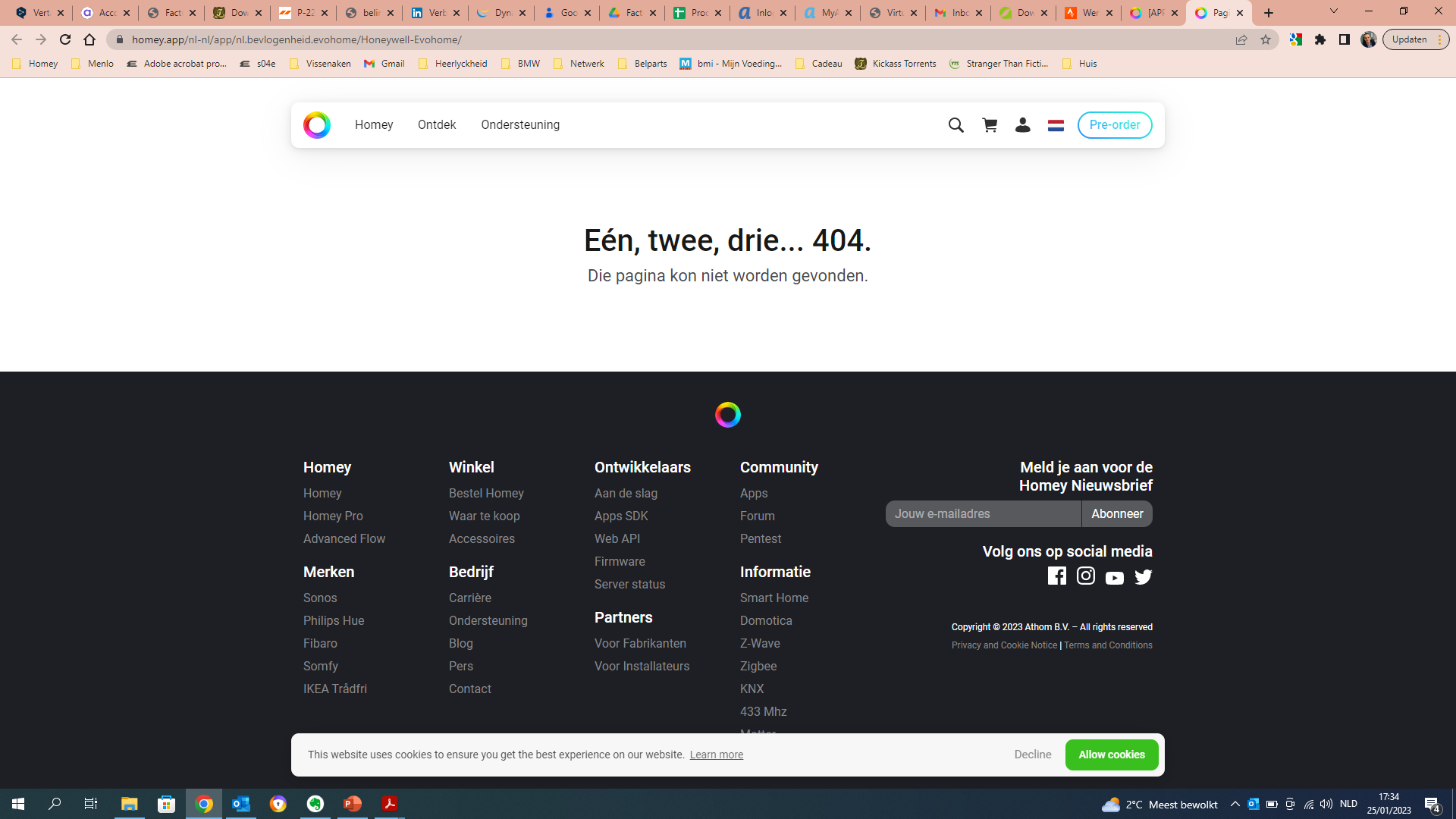

Community app offline?
As requested by this (community) app’s owner and topic creator.
This topic will be closed as Resideo Technologies (/Drenso) have created their own app for Honeywell Evohome.
This community app version has (apparently) also been removed from the appstore yes.
(Hopefully on good accord.)
Any further support (IE: issues) of their app should be done by their own support channels, links are on the app’s page.
