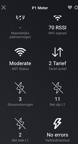

The polling interval on the P1 is: 10.
The WiFi of the P1 is: 70 RSSI

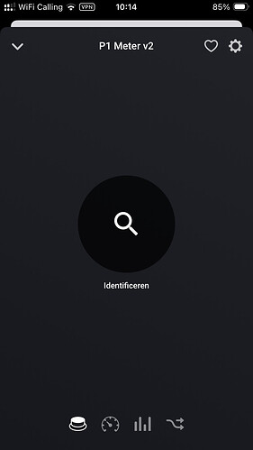

Hi Jeroen,
Homewizard P1 meter with APIv2 –> I notice a “flickering” of the dropdown for the plugin battery mode: the dropdown is shown for ~8 seconds, then gone for ~2 seconds, back for ~8 seconds and so on.
Is this a known issue? I don’t have a homewizard plugin battery, can it be related to that?
App version 3.12.7
It shouldn’t flicker so removal / add of the capability goes wrong if you dont have a battery. Drop me a diagnostics so I can trace the problem.
Thanks
b2fe18eb-a2bf-4f12-a89d-2ccf7d098db3
Thank you :+1:t2:
