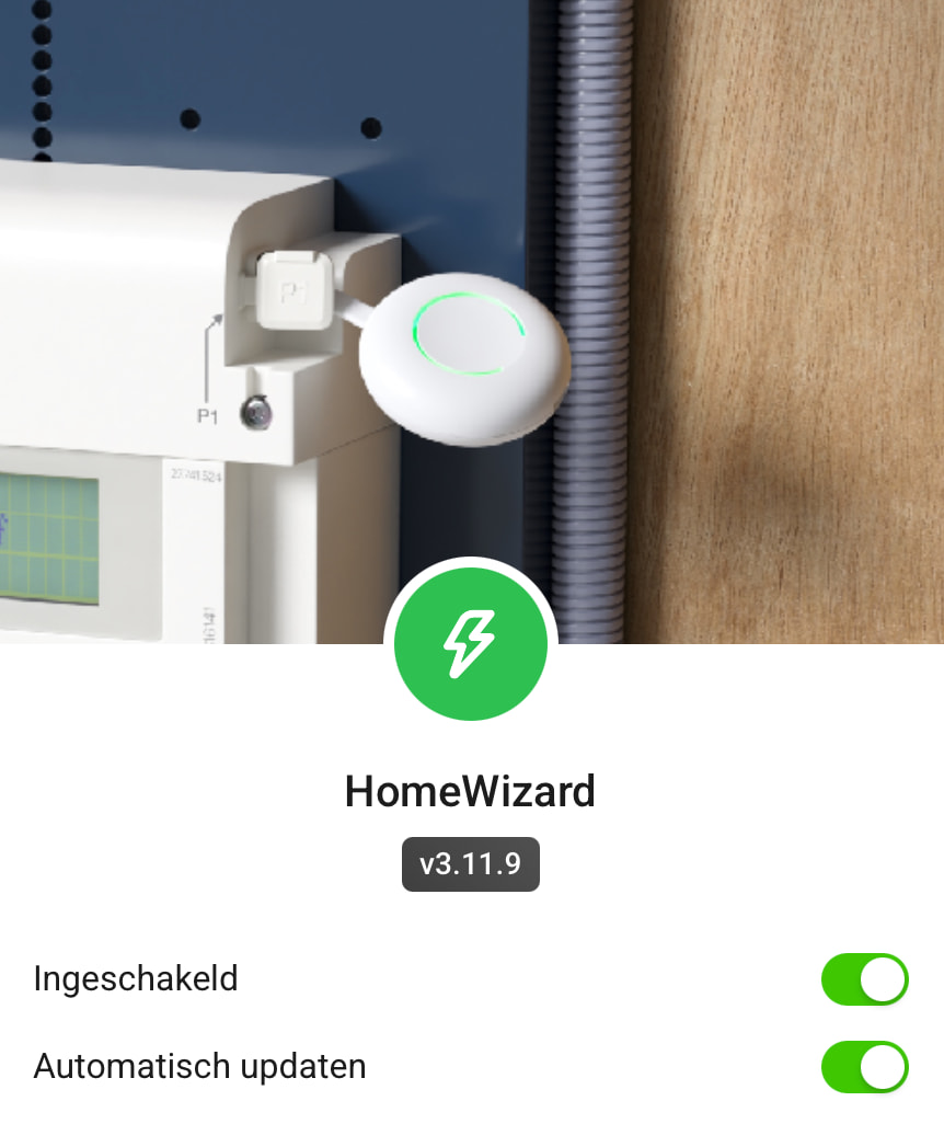

I am running .311.9 test
Since this update, my Plug-in Battery lost connection within the app.
The battery is within the HW app on Android or online, connected and working
Could this be related to latest update?
Restarting your app, or the Homey will not solve the problem for me right now
Not sure, most of the functionality got added to the P1.
Drop me a diagnostics.
5d57c912-3d4f-4a34-8ade-3524762c2558
Homey doesn’t get a respond from your battery at least that is what the log tell me.
Your P1 is websocket mode, you can try websocket mode for the Plugin Battery as well vs polling setting now. Maybe that improves the connection handling.

Testing locally but already working for plugin battery now:
2026-01-17T22:33:13.706Z [log] [ManagerDrivers] [Driver:plugin_battery] [Device:e500830d-845f-46a6-9618-29413fd91f2c] LED brightness set to 2%
2026-01-17T22:33:17.903Z [log] [ManagerDrivers] [Driver:plugin_battery] [Device:e500830d-845f-46a6-9618-29413fd91f2c] LED brightness set to 100%
2026-01-17T22:33:23.581Z [log] [ManagerDrivers] [Driver:plugin_battery] [Device:e500830d-845f-46a6-9618-29413fd91f2c] LED brightness set to 10%
Changed and immidiate online
Ah great, not sure if the tcp connection got full or response is delayed somehow. I can try to increase the timeout detection for the PIB. Websocket should be better as it is nearly realtime data (every second).
EDIT:
Other reason might be more connections are hammered to the plugin battery. Log does not say connection reset or refused only timeout but perhaps if there are multiple sessions or polling interval of 1s it will hurt and show unreachable behavior.
So hopefully the websocket method (different from polling) is more stable for you.
Polling method is fetch from Homey to your PIB. Websocket is the other way round.
The plugin battery pushing its data to Homey instead.
