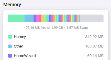

@march @Frekel @Arnold_vd_Linden @Jo_B how is your storage and memory on your Homey’s that had issues?
And memory?
It’s working again. Thanks :folded_hands:
Storage 1GB free and memory 300 MB free.
Thanks, then I am really out of options. Must be something between the Homey’s and the platform it connects to. As I got confirmed it was not my app/package itself.
