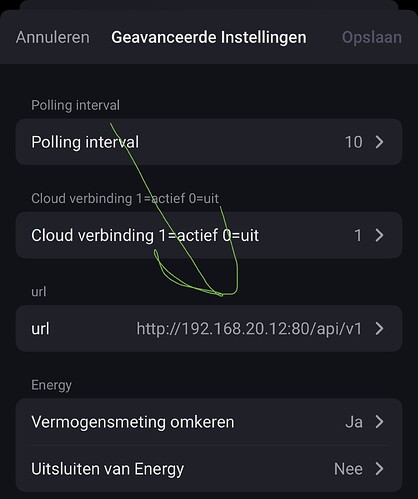

Try to update this url in advanced settings with ip you have. Only replace ip address. You might need to restart my app after the change.
Don’t have that option in the settings. Do I need to install a test version?

Try test version
Yep, that did the trick. Much appreciated for your help!
Ok, did you manually adjust the url in settings or did it recover connection itself?
No I added manually, the textfield was empty.
