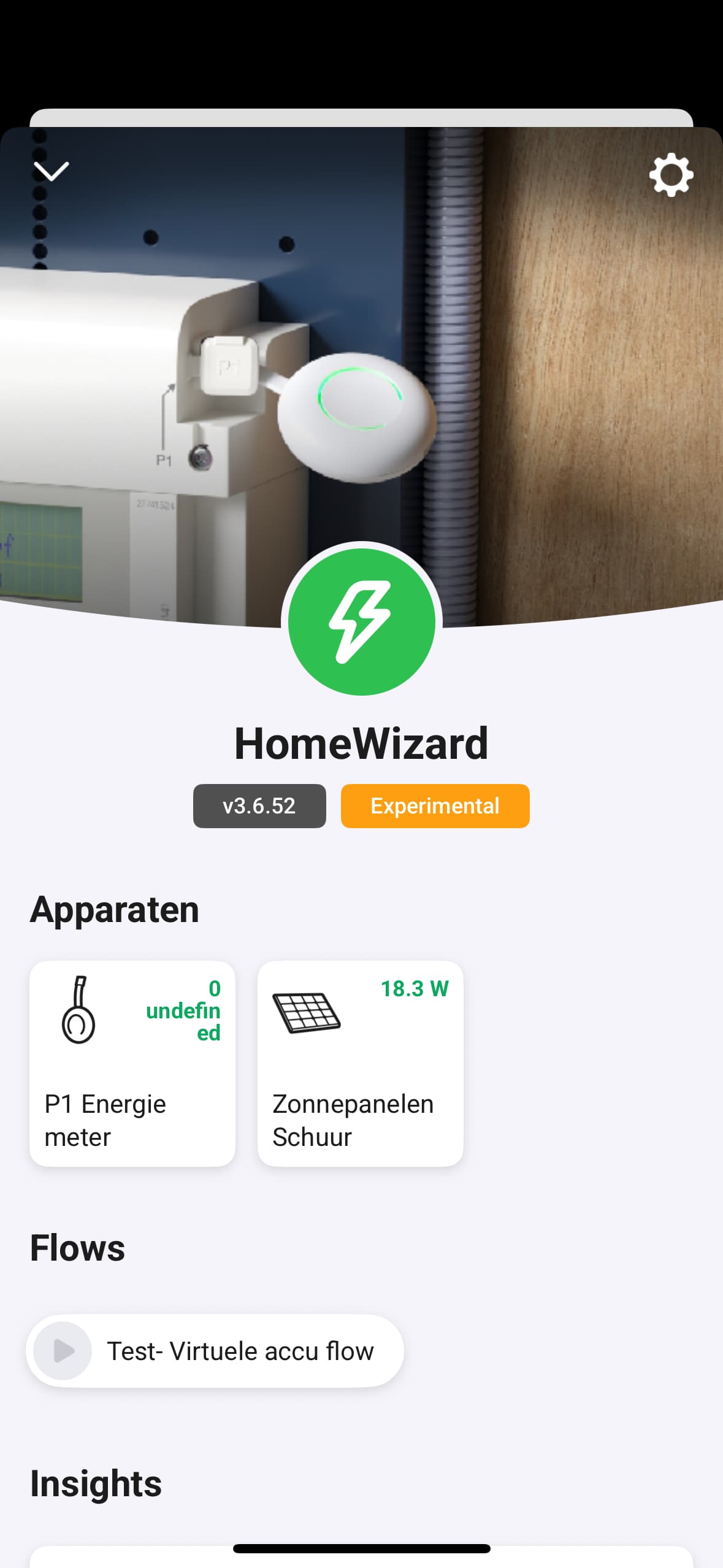

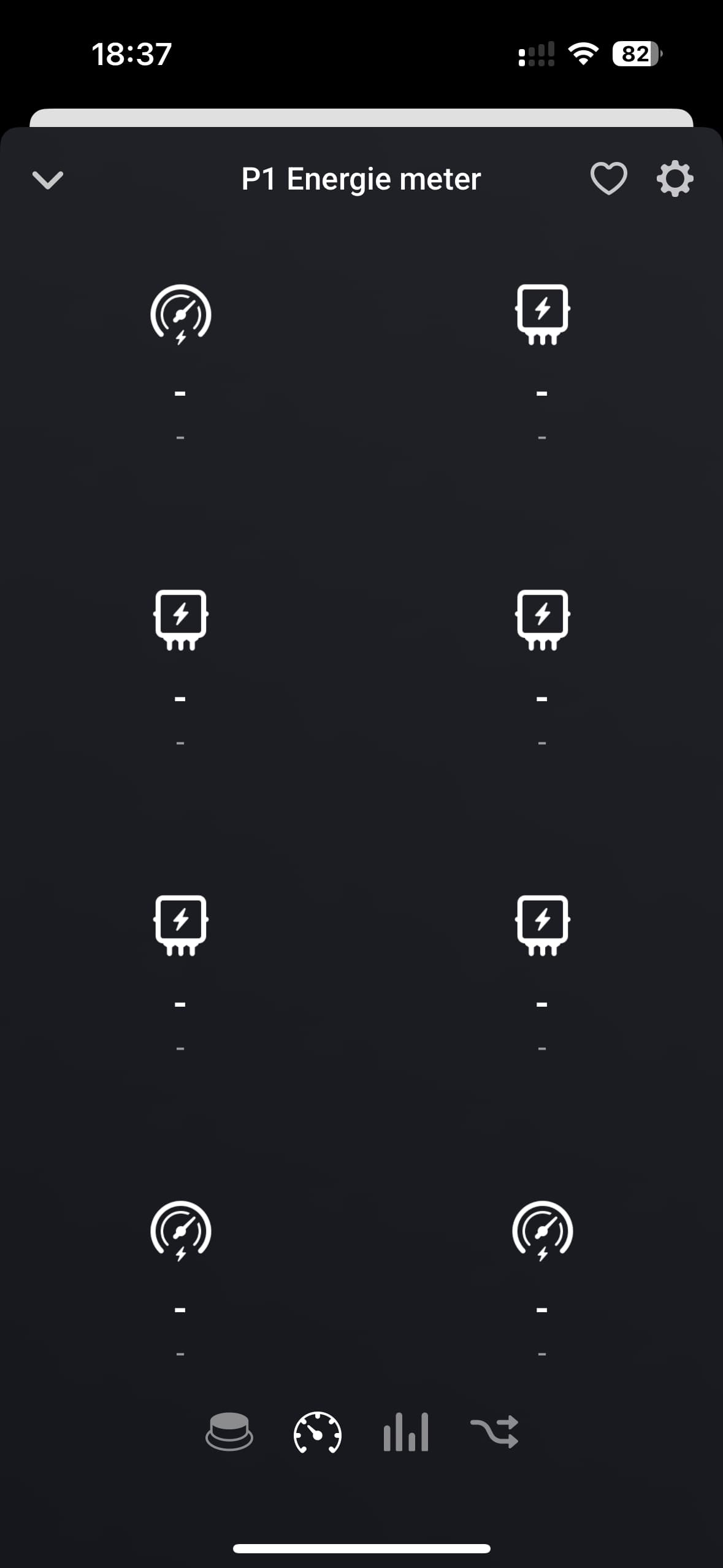

Dear Jeroen,
I also have a problem with the p1 meter
In the insights i have all the values but on the front page and de device page it shows nothing. This is since the update from 3,6,50.
I already restart homey and the app. I also removed the p1 from power but nothing helps
Maybe you have a idea? Thank you much in advance

Ok please try v3.6.51 (test/beta).
I think due to you running a 12.5.2-rc.3 on Homey, Athom introduced something new, as I dont have the error and I tested the code which doesnt fail on those capability removals.
Thank you for your help. Sorry didnt metioned the firmware from homey, it is indeed the rc3.
I just updated to the new firmware but problem is still there.

Fine I removed the block. Try v3.6.52
Okey, i updated but problem is still there on .52

Errors are gone but now I have no clue what goes on with that version…
My suggestion is to restart your AP that connects the P1 and or your Homey.
Else I feel there is something wrong with the RC you are running.
I have no problems or crashes with this test/beta v3.6.52 on 12.5.1 homey firmware.
Sorry Robin this is beyond me now. Maybe Athom can give some clue what is up.

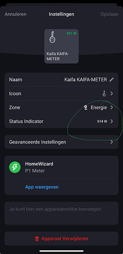

Maybe one to check is that a preferred capability is false set, try to change it:
