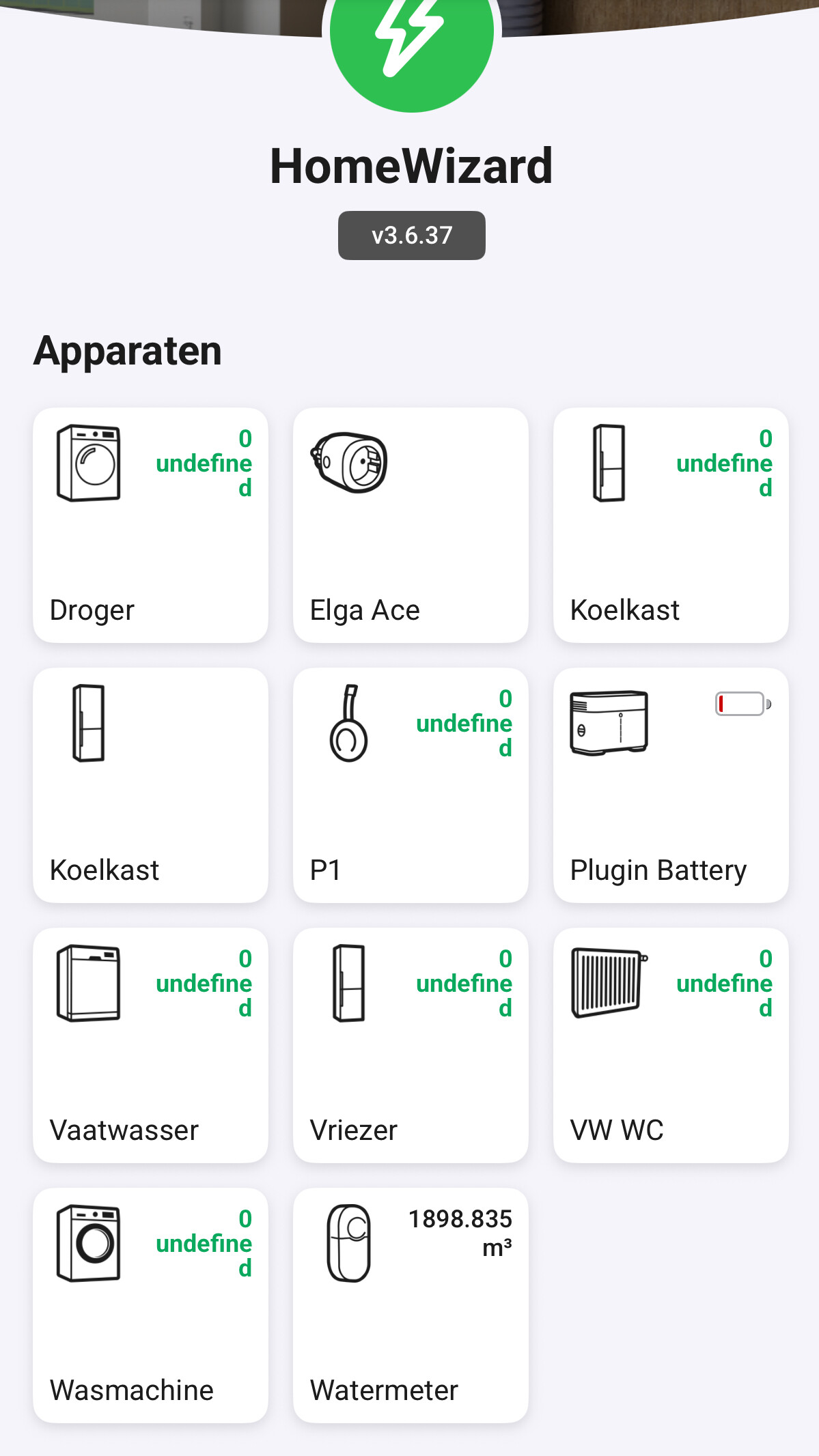

Just updated to latest version and are getting this. See screenshot.
Tried reinstalling and Homey restart but no success.

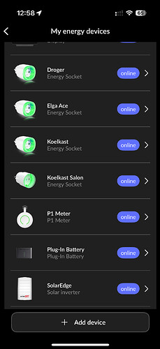

Nothing wrong in the Homewizard app, all devices are connected there.

Sorry don’t understand experimental, screenshot shows v3.6.37 which is my stable Homewizard app for Homey. Or are you on experimental for Homey firmware?

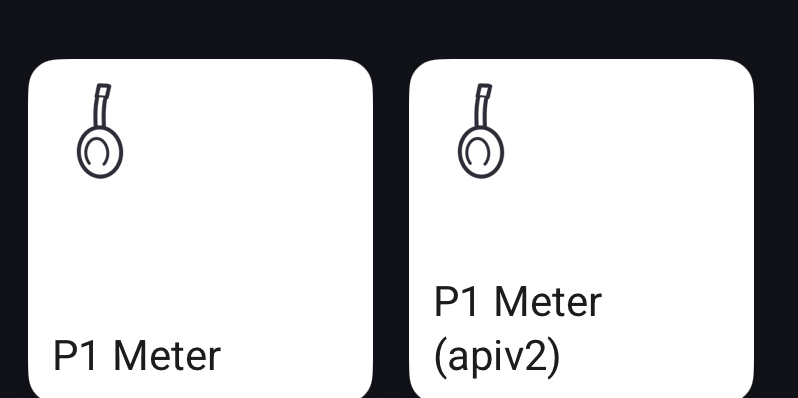

Also which P1 should I install. I see two versions now.
Right this 3 phased slider in the GUI is more of a pain and looks cool for Homey their own dongle but impossible for me to make it work. I will remove it and stick to the capability instead. I will work on an update and remove them.
What’s the difference between P1 and P1(APIv2)
Which one should I use?
Both work. APIv2 is new method and recently added due to plugin battery also supports APIv2.
