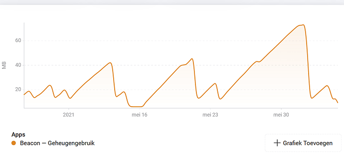

Recently my homey became a bit slow & hot which made me check the memory status of my apps.
The experimental version of the beacons app seems to be the issue.
I believe every drop in memory was a restart/ptp as i have had to turn off the power for other reasons.
Dont know if you can do something about it, but wanted to inform you. I downloaded the normal version again.
