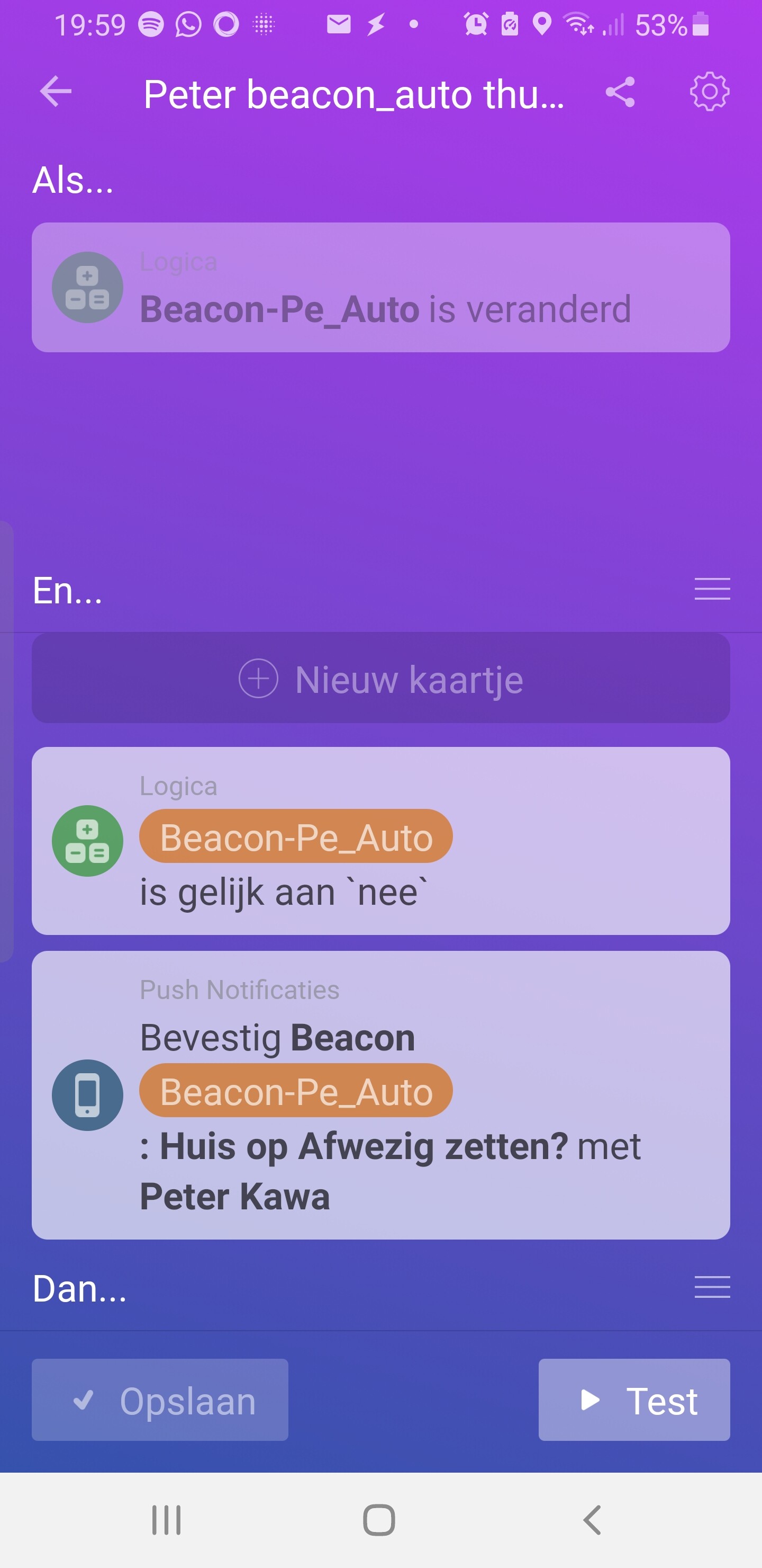

@El_Maestro You could add a condition to prevent “false positives”: the push acknowledgement card.
It sends a push message to a user.
It will ask for a confirmation if you want to set your home to ‘Away’ or not.
Thank Peter for your solution, but i find it not so convenient to work this way. I installed 601 firmware yesterday to find out my Tile Pro is going crazy. Today about 20 notifications (home/away) in 16 hours.
I think it is better to deactivate the app and (un)check the checkbox “Home” manually under my avatar in the homey-app on my phone.
