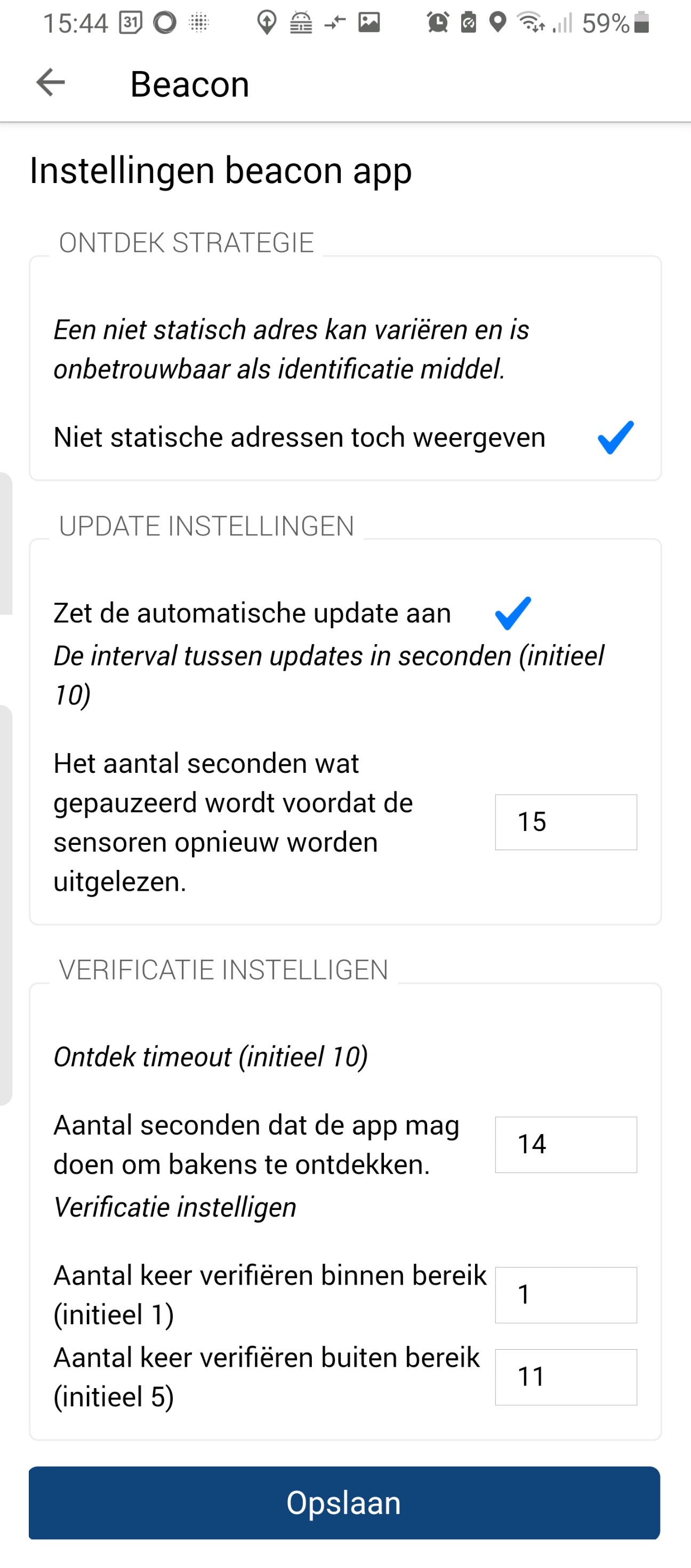

These settings work fine for me:
I collaborated with @Koktail for the new version of the Beacon app.
First of all, even though the Homey firmware 6.0.0 has relevant improvements for the Bluetooth support, still there are some minor issues that are preventing the Beacon app from working at its best. Maybe the upcoming Homey firmware 6.1.0 will solve the problems… Meanwhile the settings recommended by @Peter_de_Vos should work well (they work well also for me; if the detection is still unreliable, the parameter “verification amount outside range” can be raised from 5 to 6 or higher values).

(Running v6.1.0-rc.1)
No Beacon status changed after my last log. (Beacons didn’t move).
Anyhow, I’ll try the 30/30 sec settings
Test version + 30/30 sec + verificationoutsiderange = 15 seems to do the trick. No false detections inside/outside range in 18 hrs.
Thanks for the swift action.
Regards,
Paul

30, 30,1,11 gave a few false positives the last 2 days. So confirmed
Hi @Piero_F, I fully realised upfront this wasn’t depending on your will or ability. I asked mainly because I didn’t know if the AirTag provided (sends out) the necessary information for you guys to get it working. The only thing I see (with my n00b eyes) is that it is a similar device to Tile Pro which does work. I thought that the AirTag would send out some BLE signal (so it can be found with iPhone when close enough) that Beacon app could pick up and that it “only” needed to be added to the app as ‘compatible device’ to get this working. But obviously there is more to it than that. I will crawl back I’m my n00b cave so you can continue your work :rofl: :+1:
I have installed the Itag bluetooth tracker and am testing it. 1st day went well. setting: 30,30,1.15
After a PTP and fresh batteries for both my beacons, I am now at 32,25,1,6 without false aways.
Thx! I copied your settings, I still had a few false positives, even when 1 beacon lies next to Homey
No false positive for 4 days in a row. works fine
