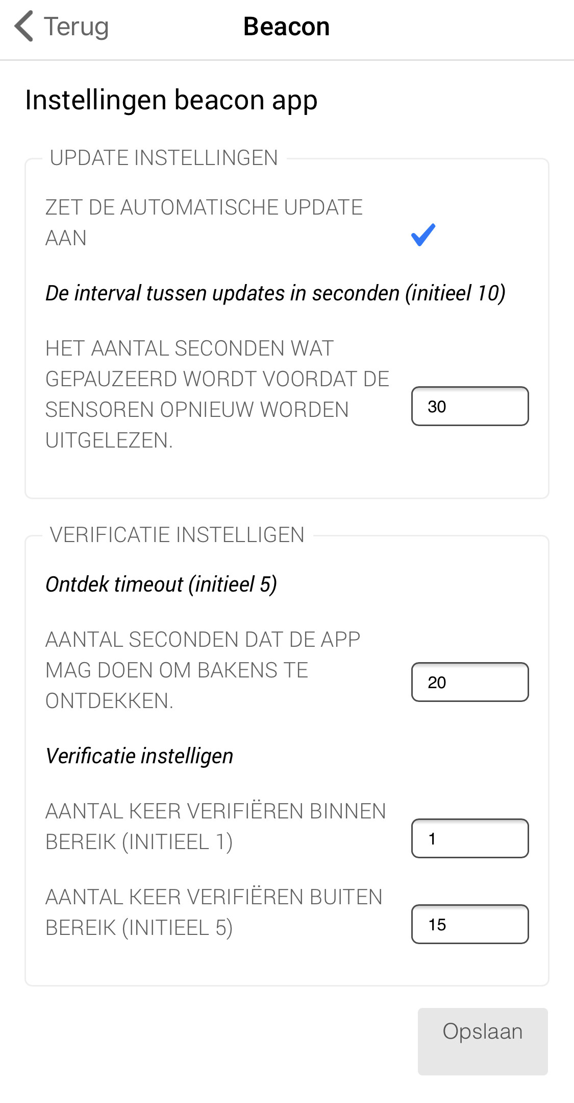

I did some testing and adjustments too. Here’s my finding. If I can do anything to check or test, please drop me a line.
I changed my settings to this:
"Interval" 32
"Discovery time-out" 31
"Verify in range": 1
"Verify out of range": 5
The flipping of beacon A has stopped. In fact these are the statusses now:

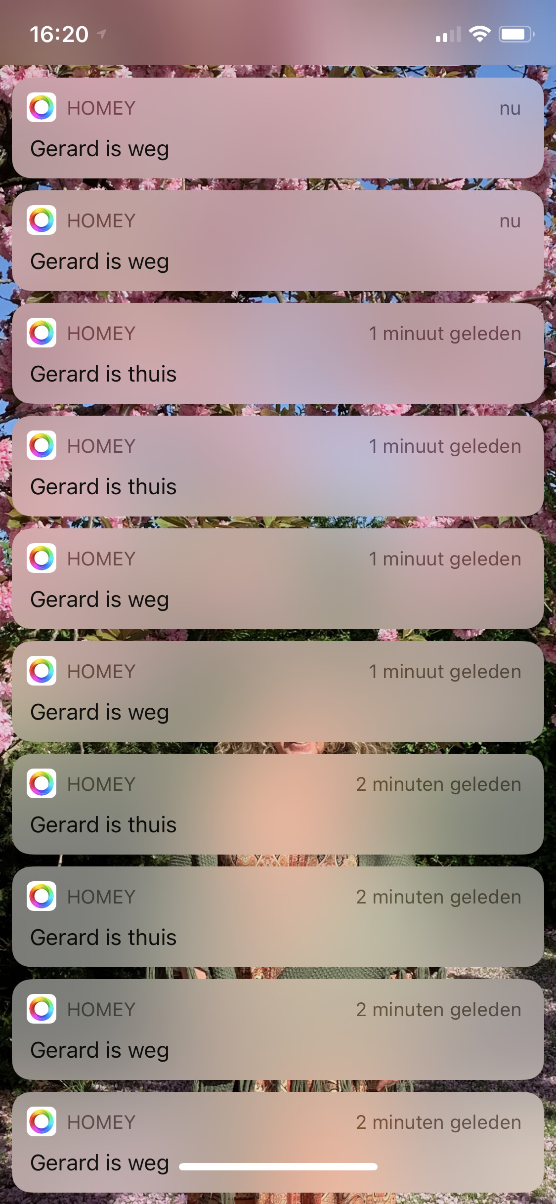

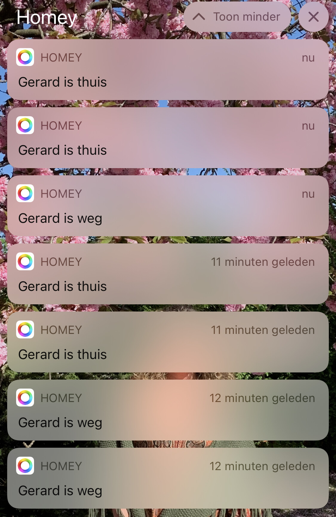

The problem is getting worse by the minute now. All notifications are doubled. This leaves me no other option… paused the Beacon app and disabled Homey auto-update. I hope this get fixed soon!

@Koktail I’m using 2 Tile Pro’s. Both have full batteries. Yesterday I did the PTP trick for half an hour. Also changed time-out to 20s and interval to 30s. This seems to have stopped the double notifications. I can live with false notifications now and then… just not 20 times a day :upside_down_face:

As of today things are reasonably quit. No false notifications so far. Maybe the PTP trick did it’s thing after all. :crossed_fingers:

Edit Right after change the settings to 20, 30, 1, 5 my beacon flows started!
Adding a beacon works again also!
Thanks and fingers crossed
I thought anything below 30s is useless b/c of the 30s cache setting with the BLE software.
I’ll try this 20s, and 30s now.
What is your discovery time out, and verification No?
My settings are now 32s, 31s, 1, 5
Prior to v6 they were 9s, 8s, 1, 11
