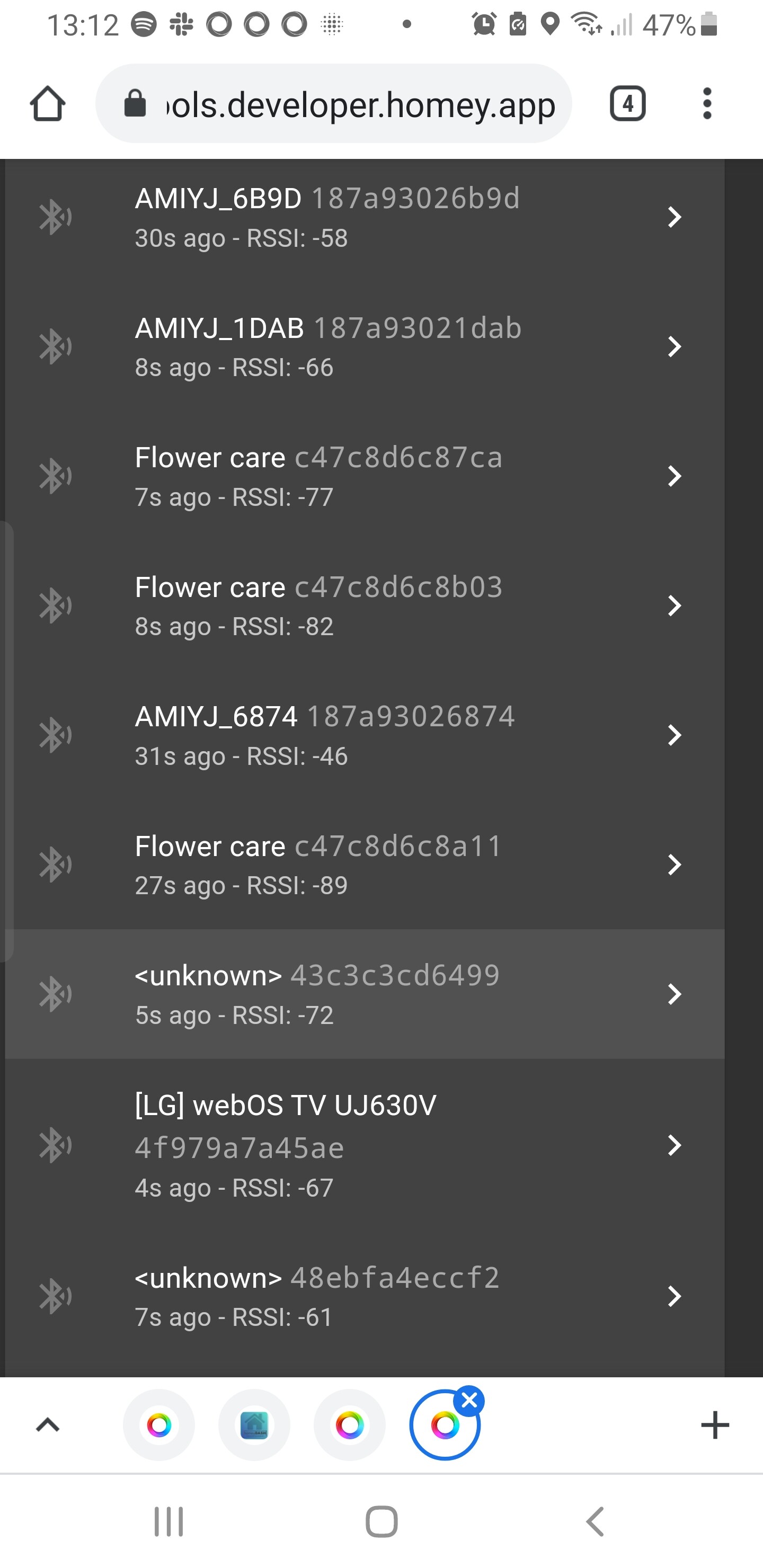

My log. Using 15-5-1-10
From my set of 4 beacons, it’s mostly the ā€˜Pe_8erdeur’ beacon which gives false positives. All 4 on new batteries.
ā€˜Pe_8erdeur’ and ā€˜Pe_auto’ lie 4 to 5m away from Homey; ā€˜Gast’ and ā€˜Lief’ 10 to 100cm.
So the distance to Homey is very much a factor here (and depends on the device brand, see screenshot)
Logs

From the BLE overview, you can see the most often flipping beacon’s (1DAB) signal is below -65db.
I’ll move them a meter closer to Homey and see what happens.
To put signal strength in perspective:
A Flowerpin, polled once an hour, works fine, with a signal of -89db.
I do not have any false report or flipping beacons anymore for weeks now.
