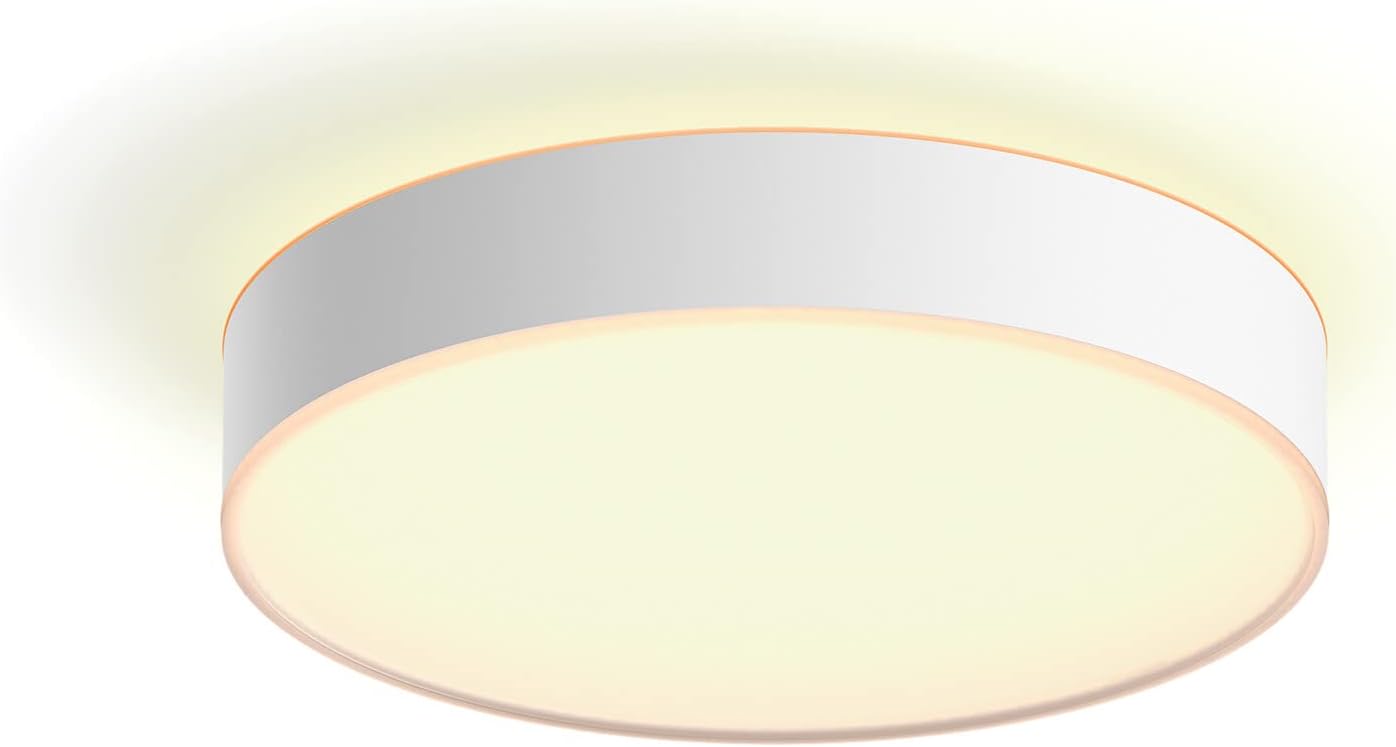

Does anyone know if the hue Devere ceiling light is compatible with the app?
I see its compatible wit the hue app without bridge but I ideally like to keep all lights connected to the Hue bridge

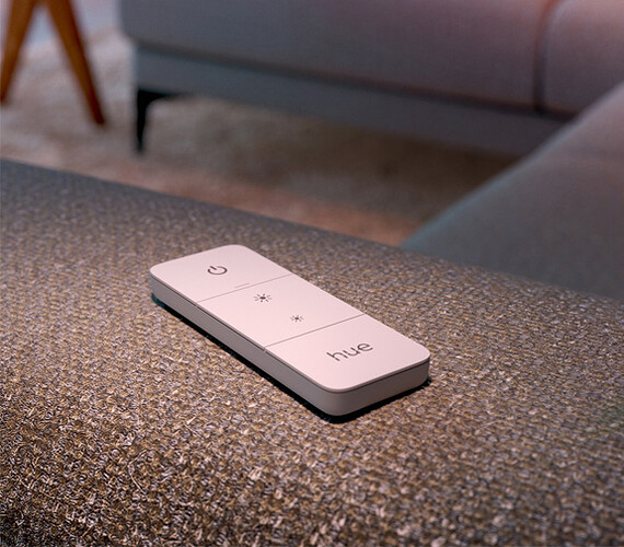

Hi
I cant find any good solution for the Hue dimmer switch.
For example: When for some reason 3 lights are on and 2 are off and i use the power on/off button the 2 lights will come on and 3 lights will turn off.
Does anyone have an advanced flow example?
