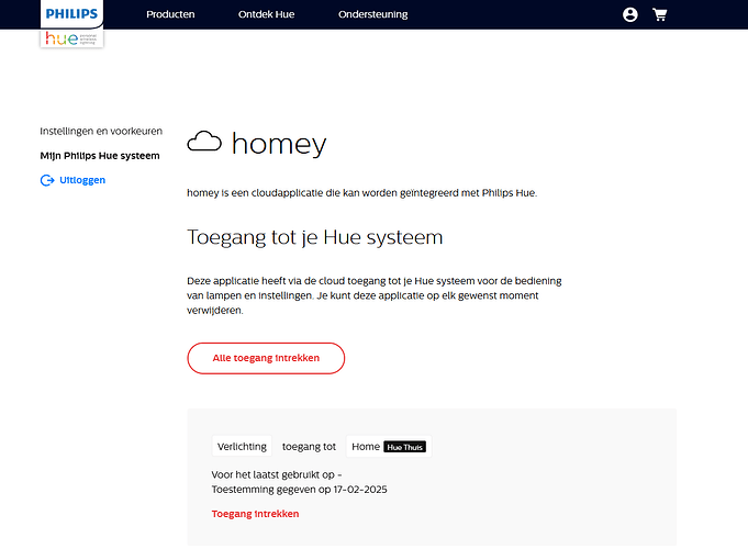

Guess I read somewhere it could be fixed by removing the Mobile Homey App from your phone and re-installing.
Maybe have a option to try on another Phone?
or try connecting it from the Homey WebApp on a PC (Mac or Windows) from the Browser https://my.homey.app/

Try adding your Hue from the WebApp.
Done that also. Chrom brouwser, Chrome app and app on ios
Do you get the same Error ?
The same error happens every time

I was just installing my new Homey Cloud bridge and got the exact same error mentioned above when trying to add my Hue account.
Error: Client authentication failed (e.g., unknown client, no client authentication included, or unsupported authentication method).

For the ones who are having issues with connecting the hue bridge to homey cloud, this is their response, I didn’t test it yet.
Response:
Hi Teun,
Thank you for reaching out to our support and I’m sorry to hear you’re experiencing issues with your Philips Hue devices on Homey Cloud. Our apologies for the inconvenience!
Our Development Team has looked at the issue and we found out that there were changes made in the authentication procedure without informing us, which is why you received this error notification.
We’ve updated the Philips Hue app, would you please be so kind to install the test version of the app on your Homey Cloud and could you please let me know if it resolved the issue for you as well?
Thank you for your cooperation!
I’m looking forward to hearing from you soon.
App should be updated by now for cloud users. I bought the Pro too this week and connecting hue bridge to the pro still works perfectly if they are in the same network.
yes, got that email as well today. Tested it and works
