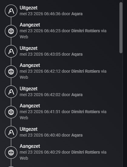

would this be the same probleme?
Same problem here with my T1 leds… Any one got a feedback from Athom support on when they will release a fix ? Half of my automations are not working anymore :frowning:
