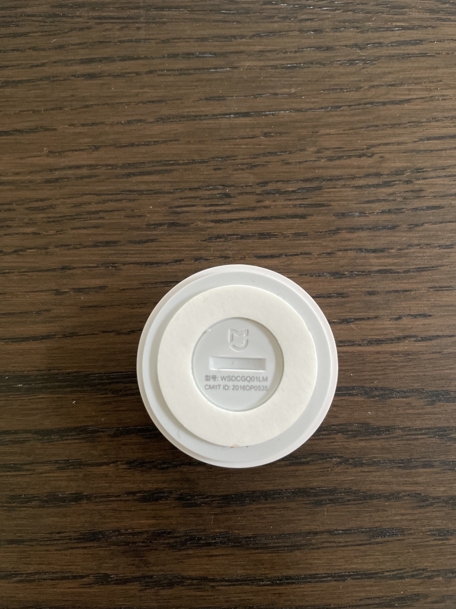

Homey 7.0.1, did a Zigbee reset. Was able to add all Zigbee devices (also Aqara) except for two Aqara Temperature/ Humidity sensors
Oddly, one of these did pair after several attempts, but I cannot get the others to pair. Just for reference: I tried a PTP, and the number of Zigbee devices does not exceed 20. And of course I minimized the distance between Homey and the sensor when pairing. Anyone a suggestion how to fix this? Many thanks!
Never mind that. I think it was the battery levels of the sensors. I will leave my post for future reference for others experiencing similar issues. Lesson learned: do not forget to replace the batteries…
