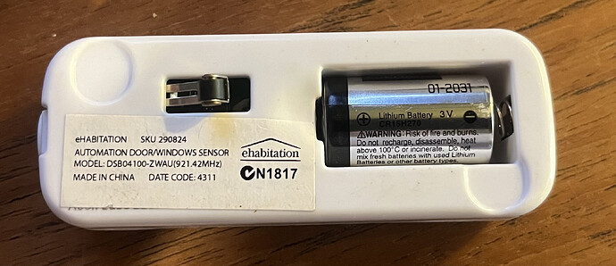

Any chance of supporting the ancient Aeon Labs door window sensor?
It pairs with Homey but has no capabilities…
I have heaps of the Australian version of this
Best would be to reach out to developer / Aeotec themselves, they are doing pretty amazing job.
