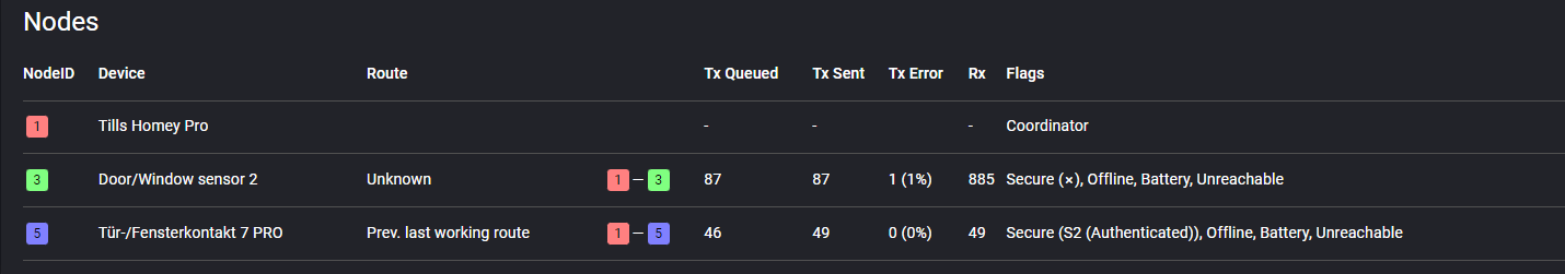

I am just testing some ddor sensors. Today I wanted to connect the Aeotec door/window sensor 7 Pro. App Version 3.8.6. After three or four tries at least sensor was found.Before installing I always test if sensor is working correctly…but nothing is happening. Seems that the contact function is not working. Battery status is shown. But no function on sensor open or closed. Attached a screen shot from Homey developer.
This is how it looks in the App
Node 3 (Fibaro door sensor) is working correctly…
Any idea anyone?
Thanks
Okay…if you press the button five times magnet is activated!!
