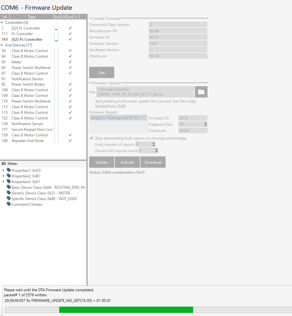

Update is done via PC Contoller SW - below screen when updating Request firmware update for Home Energy Meter Gen5 : Aeotec Help Desk
Seems that even some additional troubleshooting can be performed with this software…

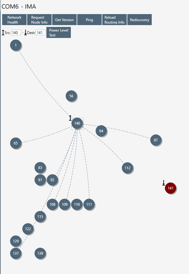

…node 140 is Aeotec ZWave repeater, the visualization is quite nice…
You can even test signal between nodes… and many many other things.

update unfortunately I was not able to make the firmware update for my Home Energy Meter Gen5 while included in the Homey network, even I replicated S0 keys to the PC Controller (communication was fine but the OTA never started) but I must appreciate again Aeotec and Chris, who was providing support and assistance again in fantastic way - I really did not expect to have feedback 5 min after I send out the question.

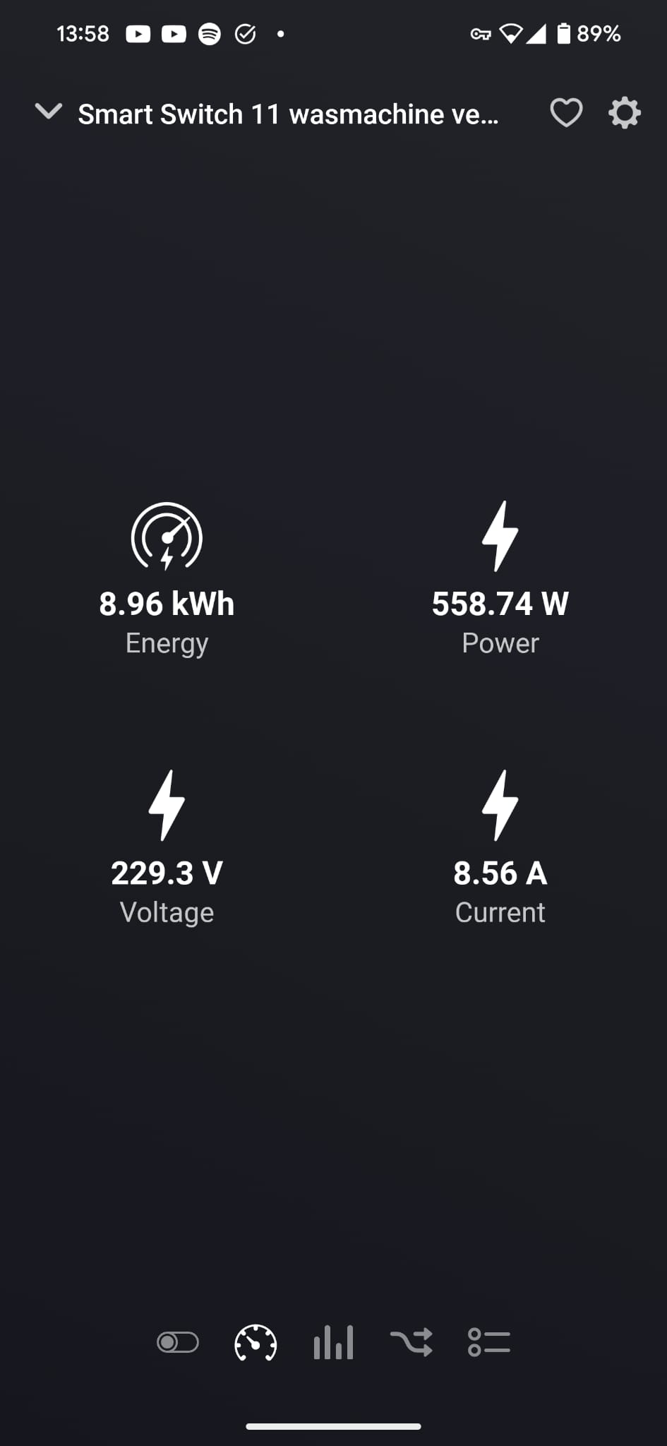

A couple of weeks ago I bought a couple of sets of the “Aeotec smart switch 7” power plug
It did look that my power consumption was really good, but that’s an app mistake.
Homey is Homey pro (2016 version)
It shows the amount of ‘W’ incorrectly, but the ‘A’ is correct. This screenshot is from the beginning of the week. v3.13.4
If you look for the ‘W’ graph, its also incorrect.
I tried to look where to report his, but I could not find a specific place
see the screenshot
Hope this issue will be solved

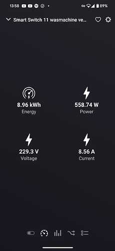

Here another bug (another of the set)
here the power could be OK. but the current is definitely incorrect
I specifically bought this set because it came out well in the comparison tool from homey

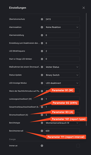

I still have the same issue.
Aeotec says I need to changes settings…
Is there any way to do this in Homey? I tried to go to the device and select “Advanced Settings” Here I don’t see a match.
Below is what I received from Aeotec what should solve the issue…
Parameter 91 - 93 (Threshold values) to 0 or the highest number that they can be.
Then configure Parameter 101 (automatic sensor reports) to report all sensors.
Then you can use Parameter 111 (time of sensor reports set in seconds) to determine how often the switch reports.
However I did find Aeotec Home Energy Meter Gen5 - Settings - #7 by Rohman
but…
It should be easy and understandable to change a simple setting if that is required…
It should work fine after a factory reset…
I selected this device because of Homey. It came up in the list of “supported” devices working with “Z-Wave”
Hi Bert,
of course it’s possible to change these parameters easily in the Advanced Settings.
This is a Homey WebApp screenshot, but it looks more ore less similar in the Homey smartphone app:
Translation:
– Parameter 91: Watt threshold / (Leistungsschwellenwert (W))
– Parameter 92: kWh threshold / (Gesamtverbrauchsschwellenwert (kWh))
– Parameter 93: Current threshold / (Stromschwellenwert (A))
– Parameter 101: Timed report enable/disable / (Berichtstype)
– Parameter 111: Timed report interval (Berichtsintervall)
And if you hover the mouse pointer over the ⓘ in the Homey WebApp, a small window opens with information about the parameter:
This info is also available in the smartphone app if you tap on one of the parameter.

Hope they make something that this kind of solutions are no longer needed or that a (factory) reset could solve this issue
Changed settings (as suggested by aeotec helpdesk) ^
