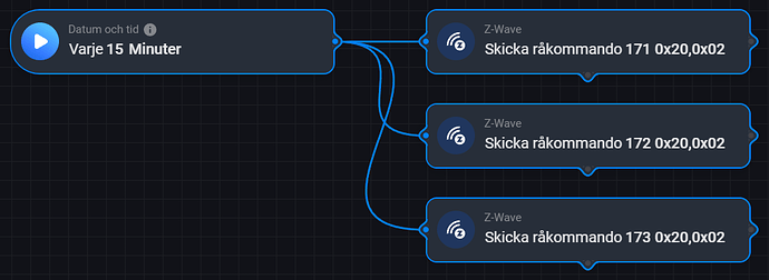

I am also using this flow to wake up qubino every 5 minuts (you have to change 155 to your Qubino node (171 or something)
I’m also sending the “Test”-command (0x20,0x02) to my Qubino Smart Meters every 15 minutes to keep them alive.
I’ve been doing it for a long time and It’s working very well.
