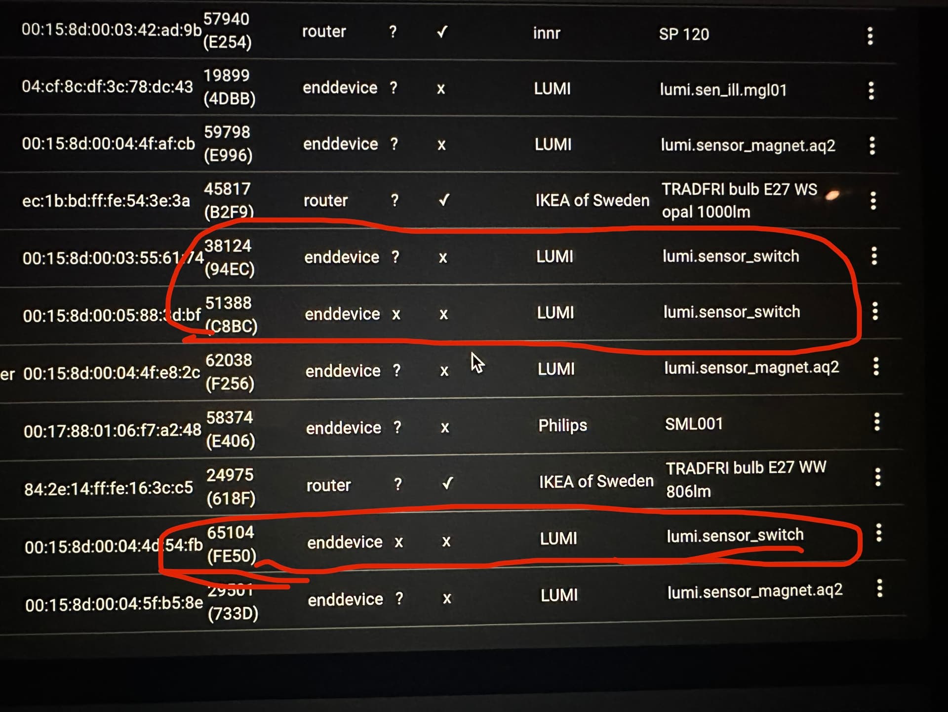

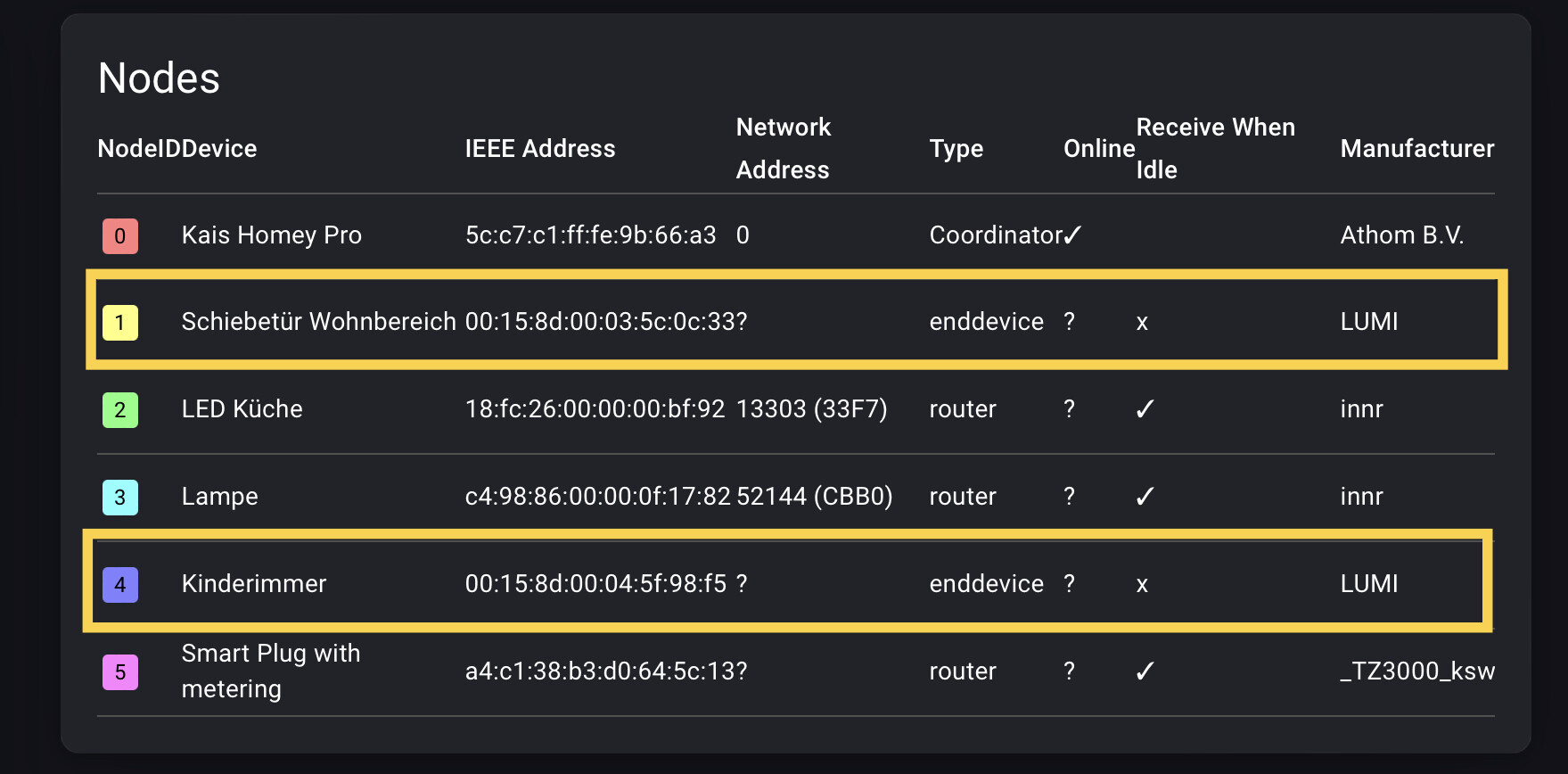

Marked the two devices. There are a lot of More but Not connected yet
Yes, Network adress is “?” …so the same error. Send diag to Athom please using this form - Loading... - Form by Asana
Also pls. delete 2nd image, as there is your network key…

Already changed channel but still same issue
Changing channel will not solve this problem - I just find interesting you had the same channel as I do have and in my case (independent from this issue) it was in collision with Wifi channel…
