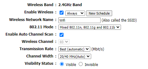

2.4 GHz setup looks like this:
With these preferences, I first thought Homey were more stable.
Now it’s gone offline 3 times a day.
Which of the settings fits better:
