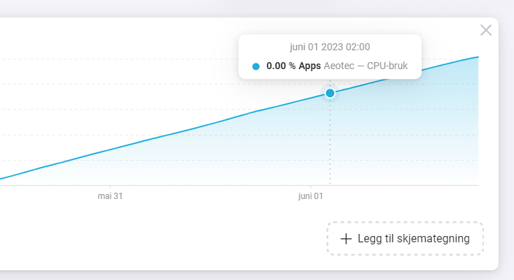

Is this the correct place? I have dragged all the apps CPU usage in here, but all shows 0%.
Instead of CPU, you’ll have to use the Memory graphs
Look for any app which used over 50 to 60MB (or higher)
I could not find any app using more than 35MB of memory.
