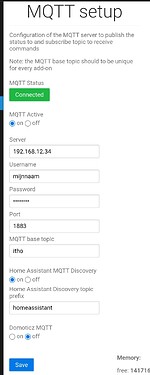

4
NRG.Watch Itho interface
Use the same user/pw as you entered at the broker configuration
Enter Homey’s IP address as broker IP
If all’s configured well, the systems now can communicate.

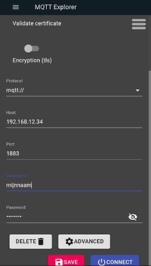

Install MQTT Explorer to view the actual topics and messages transmissions
Again you enter the user/pw as you entered at the broker configuration, and Homey’s IP address (the broker IP):

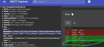

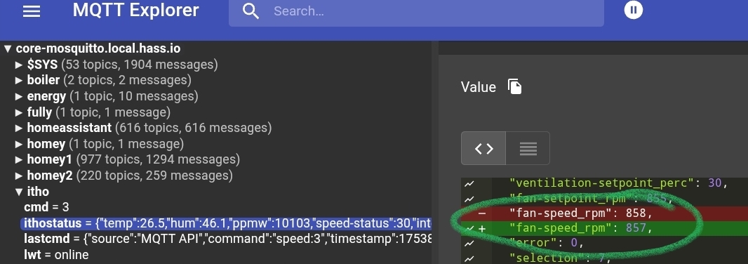

Can you show the MQTT Explorer screen with the itho/ithostatus topic? Especially the speed-status and fan-speed_rpm (or something similar), like this:
Because it shouldn’t, but it could be possible they’re not named exactly the same with our NRG add-ons….
The point is, these names should match with the ones of the valueTemplates in the MQTT device:
When the names appear to be different at MQTT Explorer, you should adjust the ones in MQTT device topics to have it matching.
Does this make sense? Just ask when things are unclear.
It’s fixed, Peter!
I had to adjust the two names and now the speed indicators are OK.
Thanks for your quick reaction, Sipke.

Hey, I’ve tried the Tutorial but got stuck on ‘step 4’. When I hit save the MQTT setup gives me the following in orange: Client Unauthorized.
Does anybody know what to do? I don’t have any experience with MQTT :grin:
Also the following from Homey:
Hi Martin,
Did you configure the MQTT broker, step 2?
Just to make sure: When you run the broker @ Homey, is this Homey’s IP address?
Make sure to reserve an IP address at your DHCP server (usually your ISP’s router) for Homey, it should never change.
However, the error message “unauthorised” says the user and/or password are not the same as the one(s) you entered @ the Broker configuration;
User / passwords are case sensitive; Martin is not the same as martin for example.
Often mobile devices auto capitalize the first word in a user / password field.
Thanks for your reply. It works now :partying_face: except for the speed rpm/%. I already saw this in an earlier post, so I need to try this out. If I’m correct; I need MQTT Explorer to check for the correct names: the following:
But now I not sure what needs to be changed :grin:
