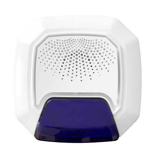

Not sure what things are like locally for you but these out door sirens are available in Australia and work well
I think under the hood they are neo cool cam
