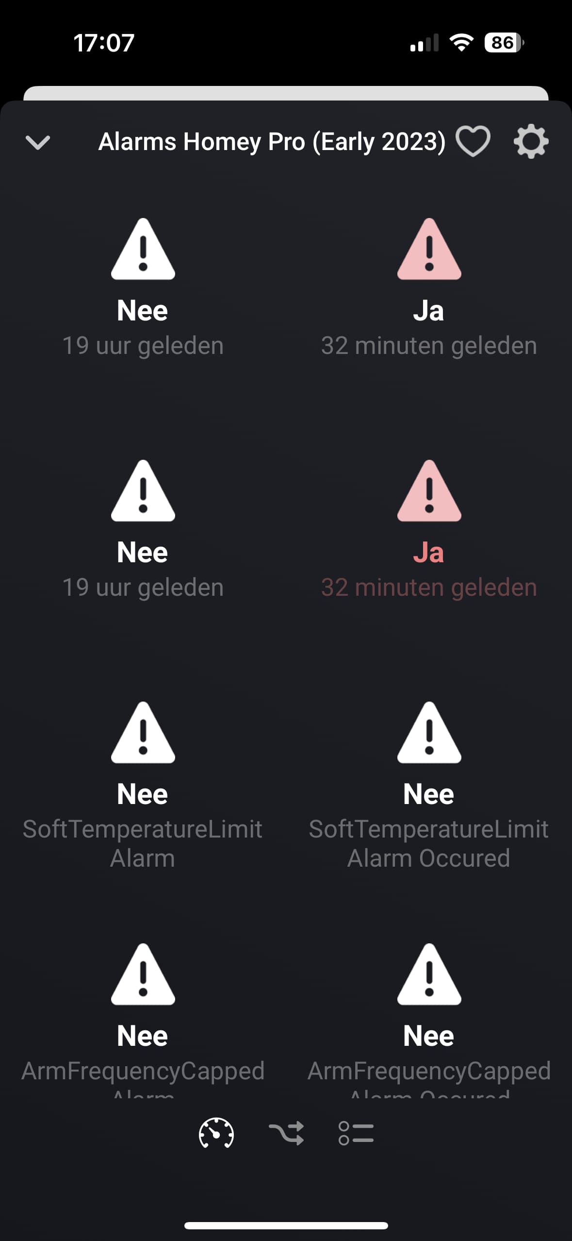

I see peaks to ~68 degrees :frowning:
Does anyone see this as a concern?
Context: around 50 devices Zwave/Zigbee/IP, around 20 advanced flows.
These peaks happen several times per day, sometimes when Homey reboots (like in this picture), but also without apparent reason at random times. Even if I am not at home and no ‘movement’ happens/load is caused by users…

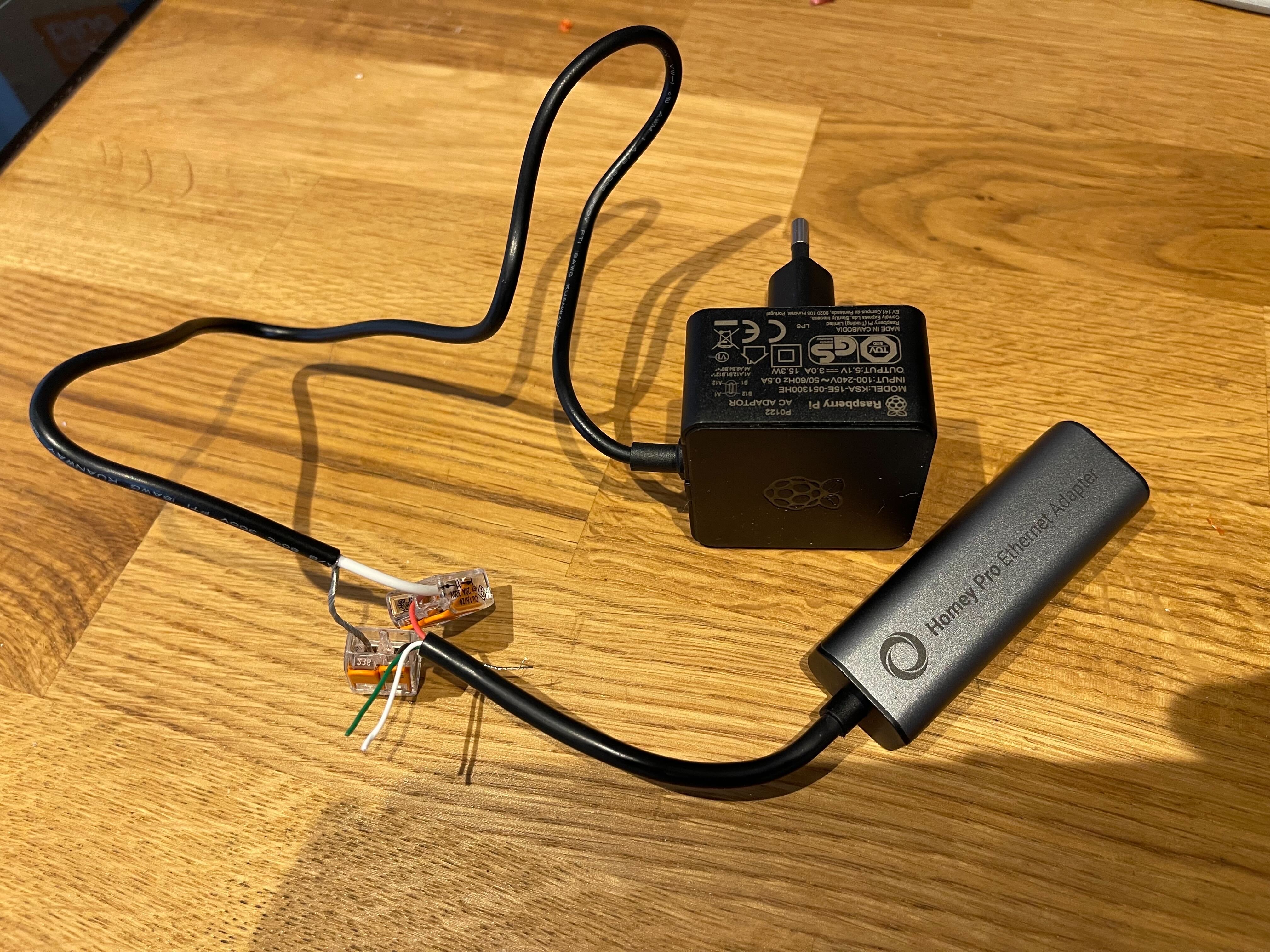

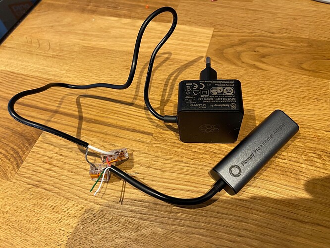

Hm…I have power supply on 5.2V and with original cable it still undervolts… after I choose another cable, now it’s fine, proved by 3 weeks of heavy loads… so I wonder, is it with cable or just Power supply ?
No problem here with the original cable, but to get a 5.2 volt supply working i made a small change to the adapter and ethernet dongle. Maybe the deleted usb-c connector is enough to compensate for the longer original cable😂

Did you try a shorter usb cable, longer usb cables (especially the cheap ones) can have quite a large voltage drop.

Like @Sharkys and @Glenn_Seegers I bought a shorter usb C cable ( Ugreen usb C power delivery) which is 50cm, the original usb C is probably to long. Now my undervoltagealarm occured is staying away.
