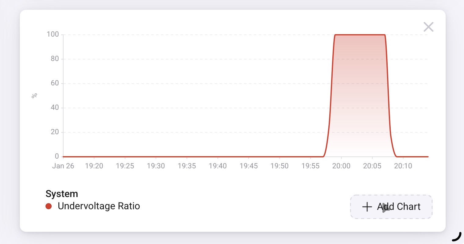

Only looking at the CPU graph is not a good indicator, maybe it just doesn’t need to step up.
You’d look at this value to discover low voltage issues:
