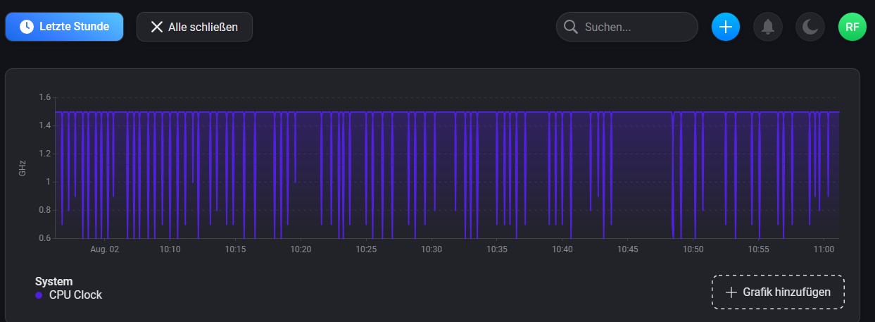

This are my insights about CPU Clock. Is this OK?
Today:
Last Hour:
Add device Alarms from Sysinternals, it will provide you more insights.
