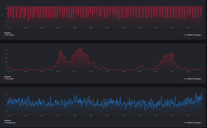

Maybe that this info helps someone. All flags on false. Stable at 1.5Ghz. Picture not possible. Every picture I select (png, jpg) is failing.

Haha, yes for sure (Homey Pro 2023). It is working stable here. Of course there are bugs. But most of them are easy to work around. Interesting to see that mine is higher in clock speed and less fluctuations with the anker adapter than on the picture from athom with the new power adapter.

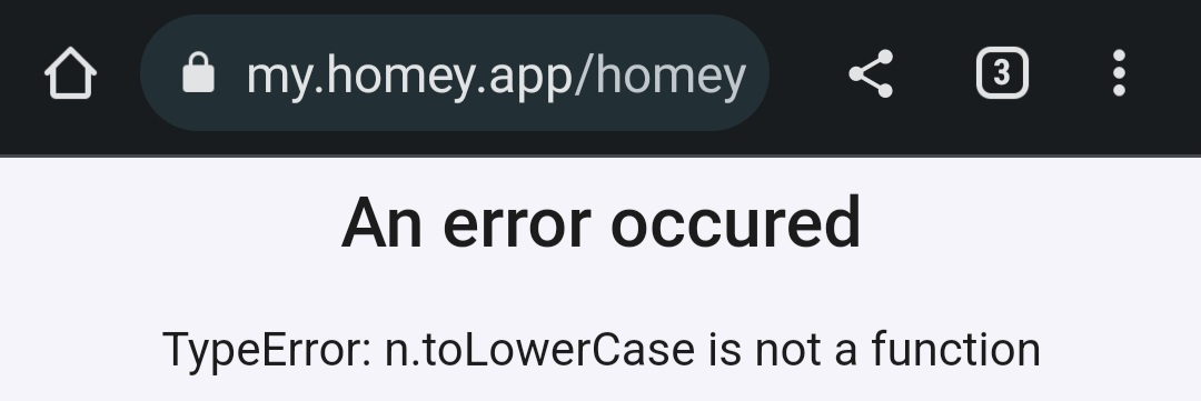

I can’t get to my insights an error message when I click on it via my homey:
