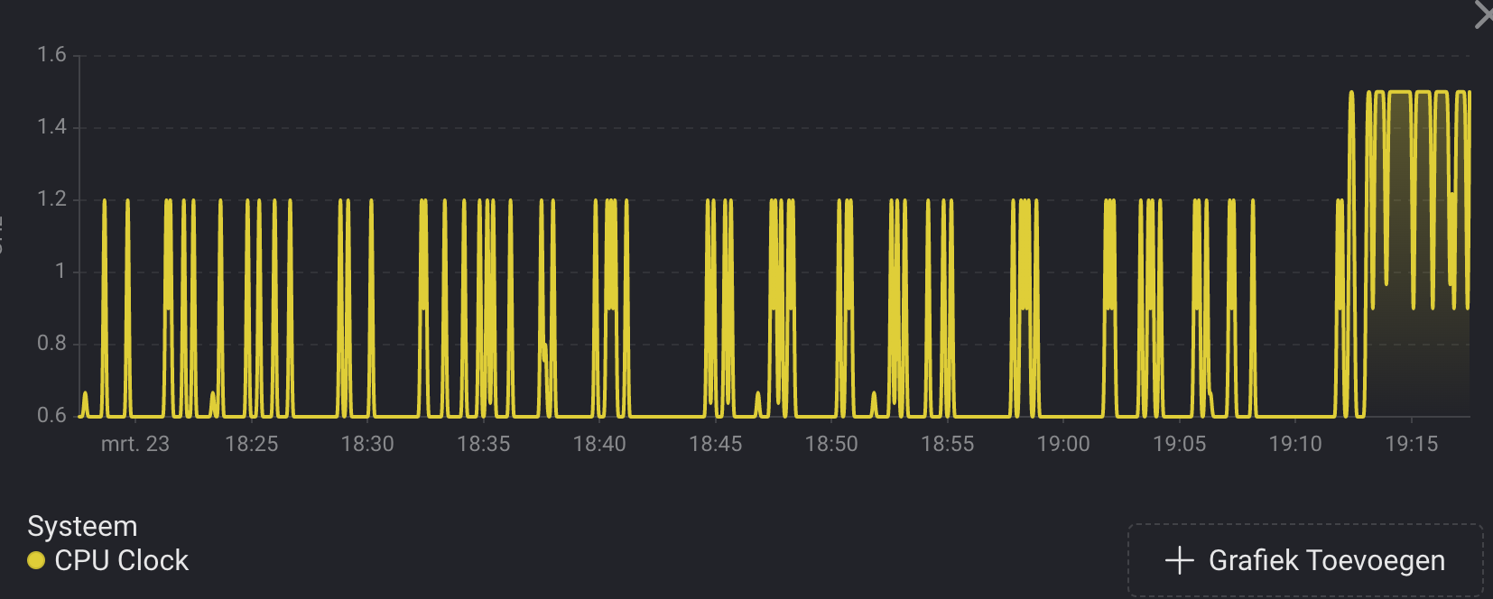

My iPad charger did flip (both) switch(es) back to “ false”.
Still CPU clock fluctuates a lot, so that charger is not really a good option.
But now we know these values are reset at a power cycle.

2023-03-23 19_44_30-Homey Developer Tools

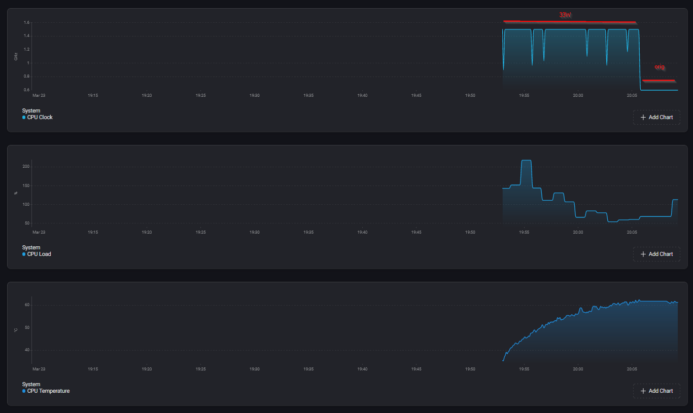

@Henk_Renting so I guess it’s obvious… with new adapter, 1.5GHz, with old one…0.6GHz…
Power consumption wise it’s however not so significant…peaks are for 33W USB-C about 1A max…with original adapter I quickly measured about 0.7A max… (but really measured quickly, 30% less performance - yet, 1A is not 15W, it’s 5W - so I wonder why that original adapter is not sufficient, probably it’s caused by the power peaks)
Some readings with the new 33W adapter :
…and also fresh restore , no timeouts and all values FALSE:
