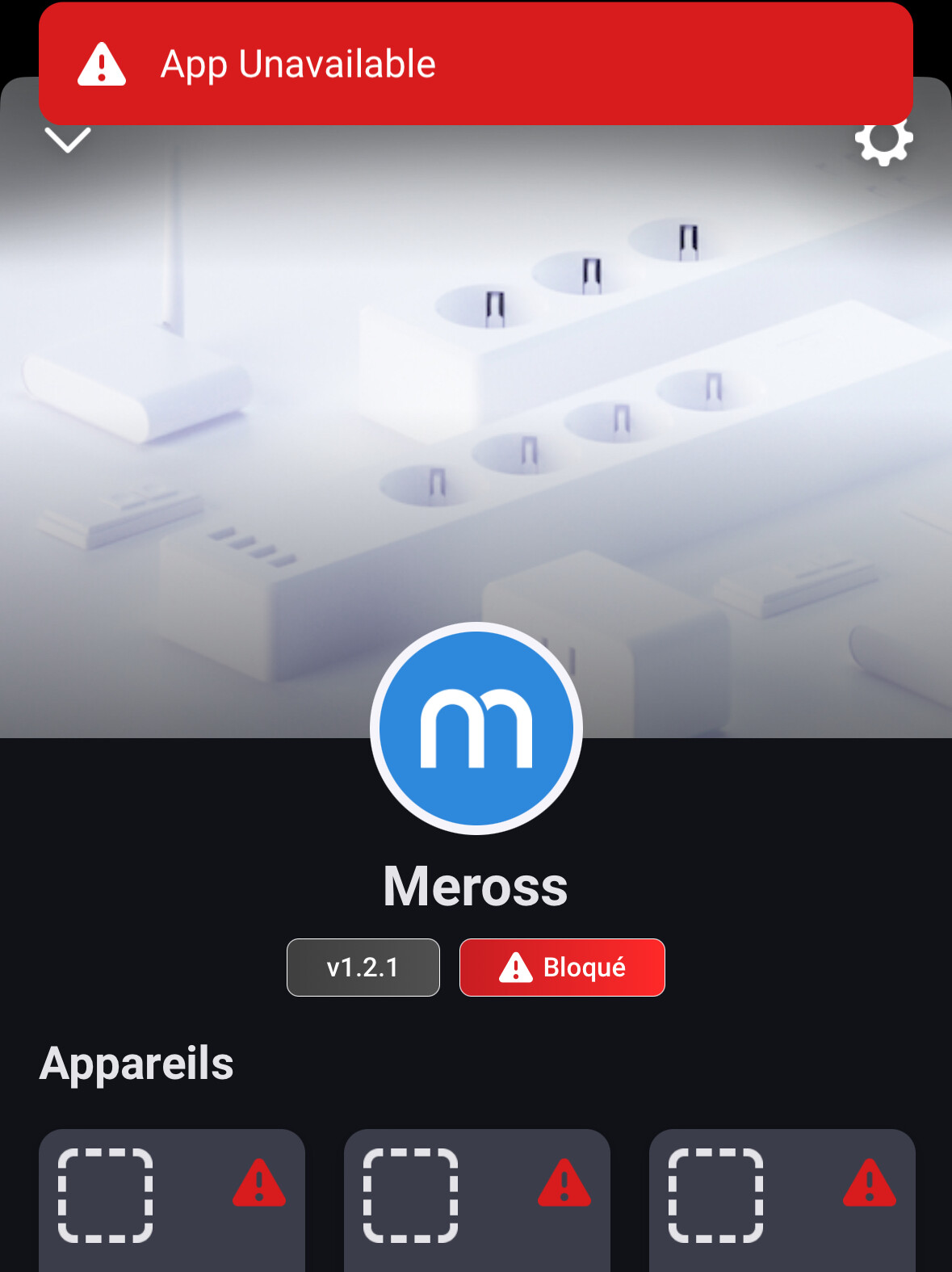

Hi, since yesterday the Meross apps keep crashing. I tried the exp version and reinstall both did not work. Now i see the message: Request failed with status code 404. :frowning:

The app is broken for me too:
