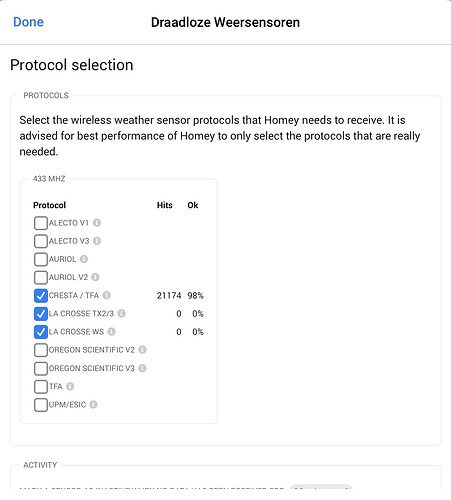

If the distance is not too far, say less 5 meters, you could use the TFA 30.3120.90 outdoor sensor, which is supported by the app Draadloze Weersensoren App voor Homey | Homey
Or another compatible one.

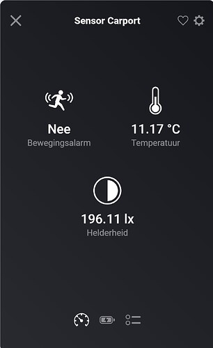

Current temperature = the last reported temperature change, which is always shown at the device tile (if you did not select an other value as status indicator that is):
