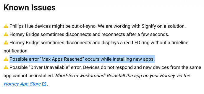

I also have the problem with Shelly. Now the Shelly app has disappeared from me. When trying to install it again, I get the message “Max Apps reached”. I only installed 3 apps! Can someone help?
Greetings Ulf
Please follow the Homey Beta Status page:
Hello Robert,
Thanks for the hint. I hope the bug will be fixed quickly. Best regards, Ulf
