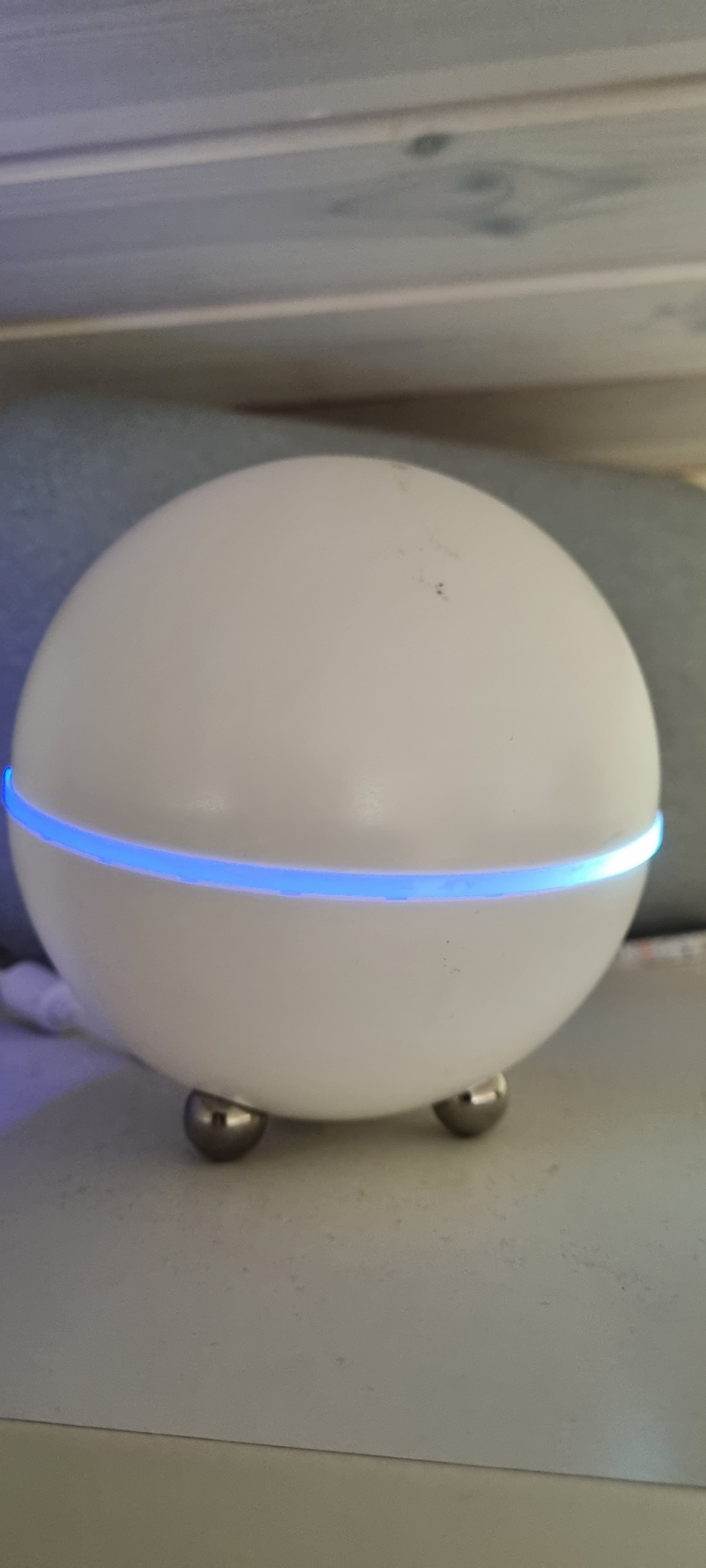

Hello. My Homey has had this light on like this for 35 hours. It’s offline, and I can’t reset it by turning it upside down. I wonder if it’s finished?

Nothing happens. It just glows like before :unamused::unamused::unamused:

And let us know, what they told you. Btw how old / which generation it is? Is the colour animating or steady ? (https://support.homey.app/hc/en-us/articles/360009618514-Understanding-Homey-Pro-s-LED-Ring)

It´s a pro from april 2021 :frowning: the light is steady.
