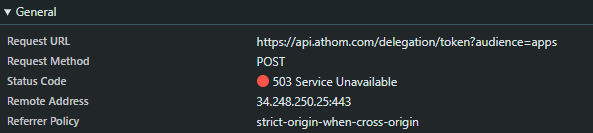

It’s not just backups. The developer tools also doesn’t work. You have to refresh multiple times, because the /delegation/token request to api.athom.com sometimes returns status code 503 or simply times out
When I publish new versions of my apps, it also says “Timeout after 10000ms” and I have to try again 2 or 3 times to publish the new versions
It all seems related to api.athom.com, their auth API. Sometimes, the avatars in the web app don’t load correctly. After checking the Network tab of Chrome DevTools, I see that the request to api.athom.com timed out
