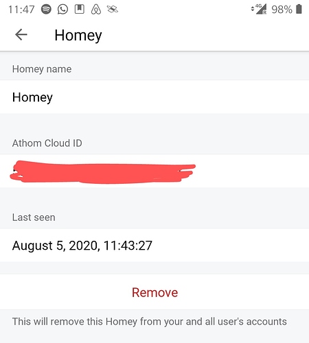

I'm on holiday and suddenly Homey is offline
Homey 2016 version is suddenly offline.
It’s 99% unreachable.
Sometimes Homey seems reachable through the app.
It then shows the device icons as “connecting”.
But before I can do anything I goes offline again.
It started first on August 1.
Do more people have a similar issue?
The issue is: I’m on holiday.
So I can’t reboot honey manually.
Any troubleshooting ideas??

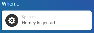

You can determine if it’s rebooting if you use a flow to push you a message that Homey has started. You have to enable power user under settings/experiments

Does this actually work? I’ve never seen this responding (Power User is Enabled)
It does.
