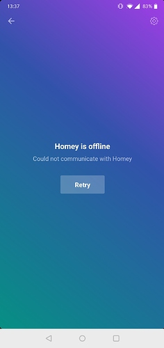

The last 2-3 weeks my homey goes offline almost every 2 days.
I cannot connect to the application and none of the flows work. If It reboot homey everything works fine again… I didnt change anything the last year and I always install the latest homey firmware updates.
Any ideas how to find the issue? A log file?
