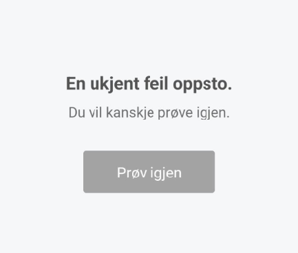

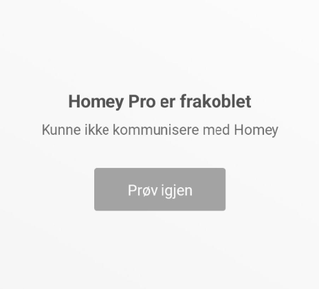

My Homey has started to go offline and be unreachable more often.
My Homey Pro was bought may 12, 2022.
Why is this happening and what can I do about it?
The red messages appear when I try to navigate through the developer tools for Homey.

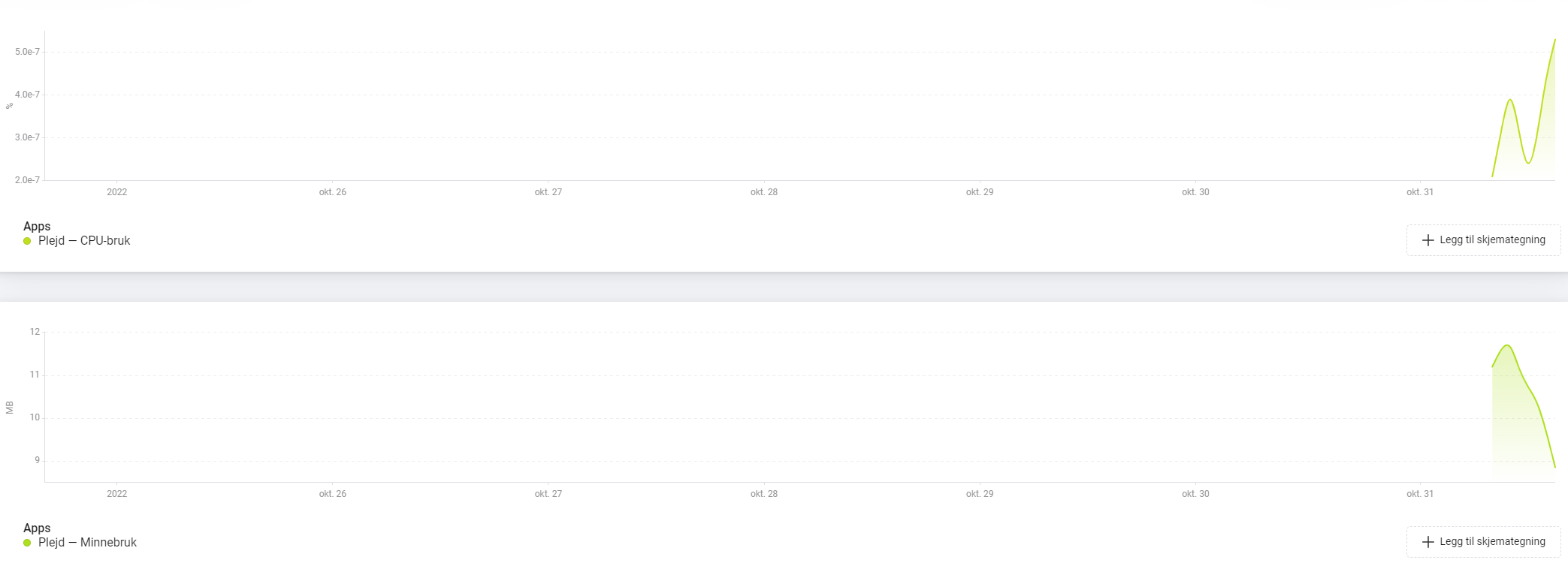

To find out which apps:
Via my.homey.app Insights you can view historical system load and memory use of Homey and apps.
Enter ‘system’ in the search field for Homey
And enter ‘app’ for an app listing.

When I try to see information about memory and storage, the app crashes and says “Homey is offline”.
Thanks, I don’t see weird stuff on your graphs. I think you’d best contact the developer: https://community.homey.app/t/app-pro-plejd/43266
