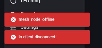

I have a problem in Developer.
When I go into developer (https://tools.developer.homey.app/) and when I then go to Zigbee, Z-Wave, Setting or whatever, I get the errors like in the screenshots.
At that moment Homey is actually off-line. After a minute or two it’s back on-line.

I started with the simpelest step first. I replaced the power adapter with 2,4A one. That solved the off-line thing.
Now I only keep getting the ‘Object’ error. Everything functions normal, as far as can see.
Any thoughts?

Where exactly in Developer view?
It happens with any of the items under ‘Tools’.
Oh, and the off-line error is back again. Half a minute later or so, it’s back on-line.
The one below is comming up again too but I cannot find anything not working.

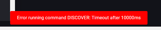

And when I try Discover under BleuTooth I get the error below.
BL

If Homey is offline, every command in developer view will result in an error. Reloading rhis page will bring the offline message.
So you don’t need to check this. Just check with the mobile app if Homey is online.
