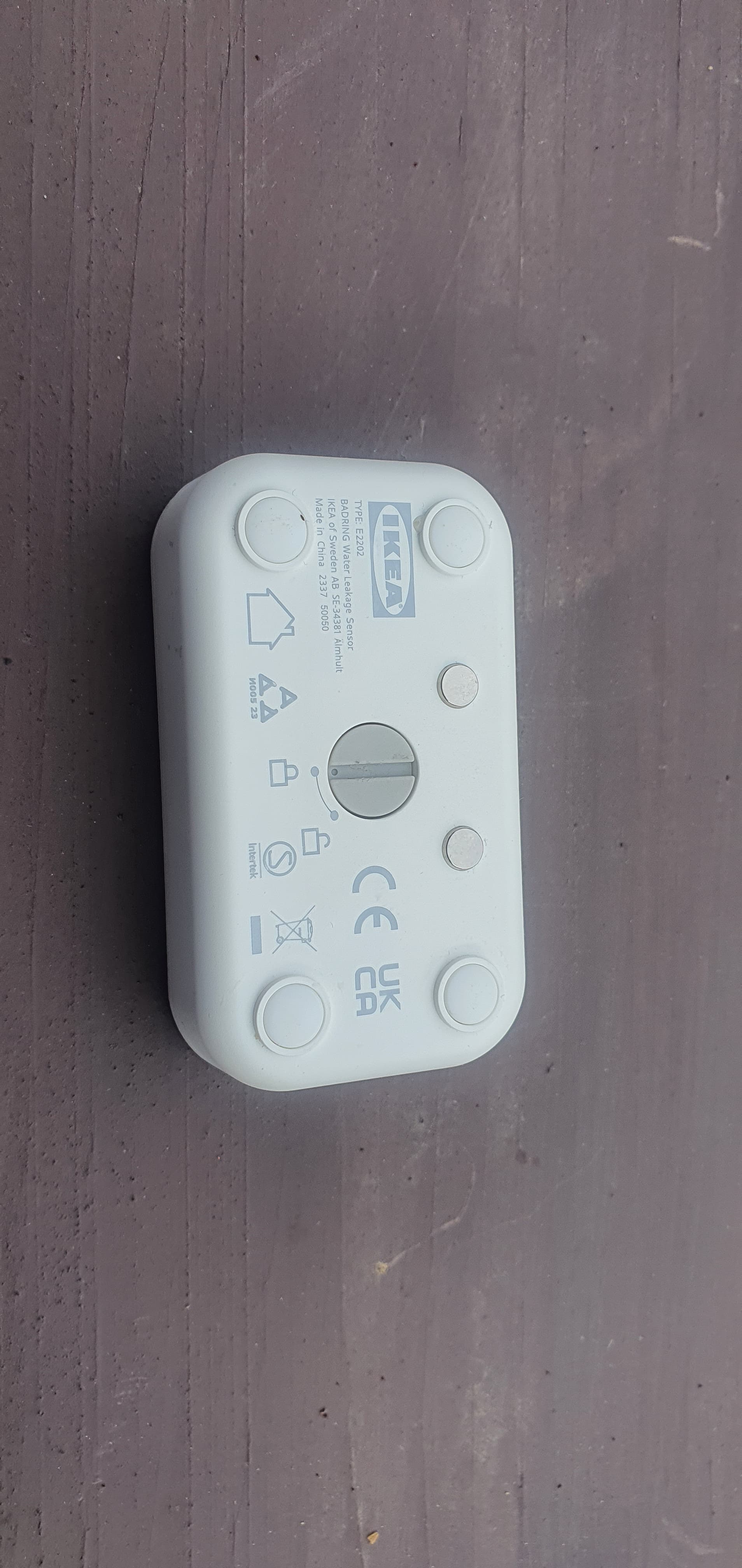

I took pictures of the sensor for you.
Its placement can be interesting, for example, with a washing machine, so that we don’t step on it…
Thank you so much handras! Nice pictures! :slightly_smiling_face:
You can clearly se the two metal probes on the bottom. Those are what I’m thinking of detaching from the “chassis” of the unit and soldering cables to. This way I can do a really slim probe unit that can be placed under say the dishwasher and placing the main unit in an adjacent cupboard for easy access to change battery and/or do a re pair to Homey.
Probably the way to go! The question is whether it can be disassembled without destroying it.
I guess it’s not needed to disassemble the sensor. The wires/probe can be soldered at the two metal “buttons”. The solder joints can then also be sealed.

I’m never scared to take things apart. If they have been assembled they can be disassembled. :smiley:
Of course, sometimes it takes destructive force…but there is glue and in this case it’s so cheep that I can take the hit just to know if it’s possible to do the mod.
I’m thinking it’s dependent of if there is a specific resistance in the buttons and between them that triggers the alarm. Testing is needed.

I don’t think it’s that complicated. If a connection is made between the two “buttons”, e.g. by conductive water, a wire or a nail, then the circuit is closed and the alarm is triggered. Therefore it depends on the medium that connects the two “buttons” in my opinion. This medium must be electrically conductive.
The only thing I can think of that might not be so easy to realize is that the “buttons” are made of a material, or possibly coated (rust protection), that the “buttons” have to be pre-treated (e.g. sanding) so that a wire/probe can be soldered on.
But of course, do some tests and please let us know your results.
I think you are correct sir…and my guess is just that…that the buttons are a b*tch to solder to. Both due to the material itself but also that they basically are heat sinks and you would need quite a bit of heat to get the solder to stick…probably resulting in the seat for the buttons in the plastic cover to melt.
