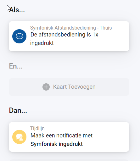

This flow doesn’t result in a timeline notification as well:
I have mailed Athom support about it.
