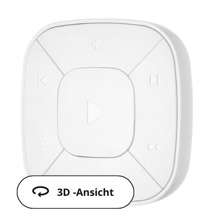

Hey i bought gen 2 symfonisk controller and i can’t add it to my new homey pro. Didn’t reconized. Someone have this issue
Do you mean this one?
IMG_3622
Did you checked in the App Store if it is already supported by the IKEA App?
No, it’s not! :man_shrugging:t3:
So please contact Athom for adding the device.
Thank you i though both were not linked
The Gen 1 Symfonisk remote is of cause linked:
@flo_31, it’s a new version of the IKEA Trådfri app released, including support for the Symfonisk Gen 2 remote.
I bought the Ikea Symfonisk Gen 2 today, and can confirm that if works on HP23 with the latest Ikea app. Just a brilliant remote, this is.
