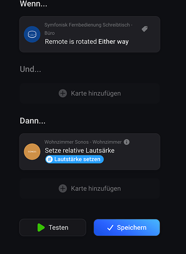

Thats my Flow
and this doesnt work
You don’t explain exactly what doesn’t work and what your goal is by rotating in any direction.
Have you already checked both flow cards separately?
– When Remote is rotated (Enter way / Left / Right), then send timeline notification.
– When This flow is started, then Set relative volume (# Lautstärke setzen)
As already mentioned, the first gen. works in both directions, but you have to select Left or Right instead of Either way. I used the RC myself a time ago.
According the 2nd gen. I don’t own it but it will certainly work too. This one has two separate buttons for the volume up and down. In the flow card then you have to choose which button is pressed, volume up or volume down:
Or what do you expect how it should work? As long as you hold the volume up button, the volume is increased until you release the button?

my Flow is this
do i have to setup one other flow?
Ok, I guess I got it now.
As I mentioned already, instead of Either way, please use Left or Right. That means, that you need 2 flows. One to increase the volume and one to decrease the volume.
The other point is the Sonos flow card. Instead of using the tag (# Lautstärke setzen), please use the slider to adjust the volume:
15 % means, increase the current volume by 15 %
-15 % means, decrease the current volume by 15 %

i dont have any Left or Right
Counter clockwise = Left (Gegen den Uhrzeigersinn)
Clockwise = Right (Mit dem Uhrzeigersinn)
Thank you very much now it is working Dirk.
ich was testing this first only in one direction but you have to setup 2 Flows after that it is working. If you setup only one flow the slider is going from 0 to 100% :slight_smile:
