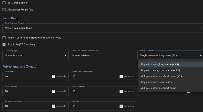

I think I’ve setup MQTT Broker/Client/Hub as it should, at least I can publish Homey devices to MQTT (I see them in MQTT Explorer) and I can discover them back (but I dont see the values published automatically).
I’ve setup EMS-ESP to publish to MQTT, I see data in MQTT explorer, but I cannot discover the devices by MQTT Hub.
EMS-ESP supports those settings and homeassistant and Domoticz naming standards (but not homie).
Can you give me some hints what to configure in order the MQTT Hub discovery works ?

I would like to to use this functionality, but somehow i am not able to create a MQTT device, discovery does not work with homeassisant/ and creating a manual device is somehow missing a “create” button.

Any option to use the discovery function, the heatpump has several devices with about 300 topics, dont want to configure this manually…
