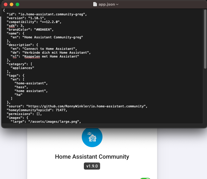

I tried with the other App.
i don’'t see a second instance “home-assistant.community-greg” in the AppList on my homey, sadly…
note :
  • in step 3. (see above, my first post) I was not asked to log in, no webpage opened
  • in step 4. I was not prompted to select my Homey device as Active Homey
you will find below the screenshots of my attempt
→ “npm install is up to date in 879ms” (is it good?), and
→ “remote” is an unknown argument (is it bad ?)
thank yo for your help ! :slight_smile:

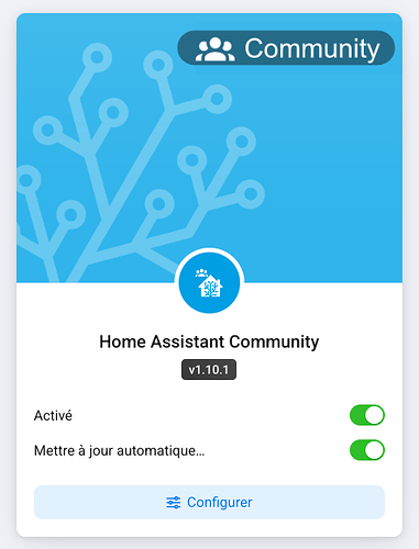

thank you Peter for the explanations :slight_smile:
i already had the HAC App installed on my Homey !
I installed again 5 minutes ago like you said, without the changes in the code and no --remote flag : it worked or so I think (overwritten) because the version was v1,9,0 (see screenshot yesterday) and is now v1,10,1 (see screenshot below). Right ?
