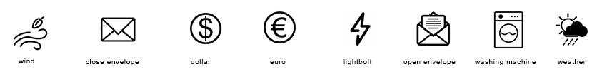

v1.3.0 is now available.
ADDED:
  • Dutch traduction
  • “Custom_Weather_Icon” card can be call to change the weather icon.
  • New “Device_Type_Zone_X”: “compare” that compare previous value with the actual and display an up or down arrow
  • 8 news icons
CHANGE:
  • Language is now need to be define with SSID and PASSWORD
FIXED:
  • Time deep sleep/ DeepSleep Enable, was not save in flash memory after reboot. It’s solved
Update guides for this is in progress…
