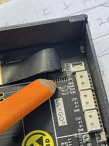

its this Chip that is making the sound! if you are updating the screen it pulses. pretty anoying not sure if this one gets hot otherwise i wil drip some hot glue on it …

If the chip is so hot, you can use a cooler like this (if you have one)

no i dont know if its getting to hot :wink: its the chip that is makeing the noice, If its not getting hot il dip it in hot gue to isolate the sound a bit!
